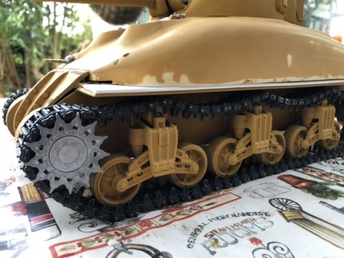

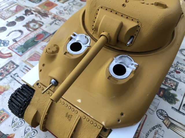

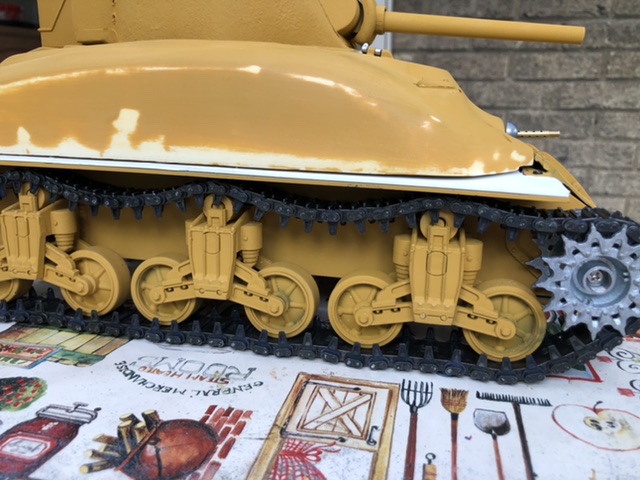

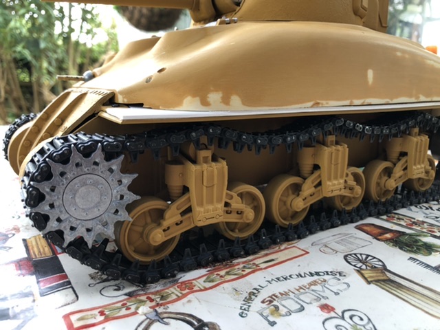

So after some part came today from Dave here is today’s offering.
Machine guns placed but not set. Seem a good fit.
Tracks installed again just checking for fit and adjustments not final
Hatches placed.
Tracks may be too slack

What tracks and sprockets are you using?
Exhibitedbrute
Posts: 1312
Re: Early m4a1
Post by Exhibitedbrute »
They are matos after market Heng long series t49 track with sprocket and idlers from forgebear but he only had 5 sets left when I ordered these.
Estnische
Posts: 1065
Re: Early m4a1
Post by Estnische »
So you have done well if you got them to fit on Heng Long gearboxes.
Exhibitedbrute
Posts: 1312
Re: Early m4a1
They are aftermarket part made to fit Heng long but should also fit Torro/Taigen as many of my t34 based tanks have Torro tracks and wheels some of which are on Heng long hills and gearboxes
