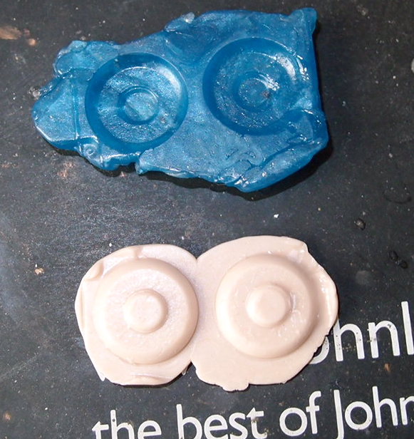

If this has been done before sorry. Am still thinking about 3D printers, resin looks much better but cleaning etc? PLA don't like the time taken if you don't want the build lines . Blue Stuff is clean ,reusable and the parts come out with little clean up if the mould is done well. Saved me a fortune in aftermarket parts. Example here , even the Mr Surfacer finish from original is good.
No mess , drop in hot water and you can make another mould.

You could also try Apoxy Sculpt. That is a bit more widely available, I believe.
It’s a two-component, non smelly, epoxy that doesn’t shrink and also takes details very well. Only thing needed is to wet the part You want to copy, press it in, takeout again. Wait 30 minutes to harden, and then go about casting as You’d usually do.
Apoxy sculpt is rather versatile, and VERY good for making/adapting figures.
The réal advantage of Blue Stuff, is that it can be used over & over again by dunking it in water and microwave it for a bit. Oh, and because it remains somewhat flexible, it won’t damage the cast if You accidentally have a bit of an undercut somewhere in the original.
