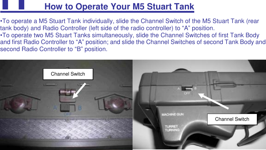

I am not an RC guy or collector. I am a 66 year old grandfather that was given a 1/6 M5 Stuart Tank for father’s day years ago. It sat on the shelf all these years. It is time to pass it down to my little buddy (grandson). I pulled it out to make sure it works after sitting all these years and it was a little erratic. A new battery and running it seems to be smoothing it out. I panicked and bought another (as-new) remote but it seems to be another a model. The tank doesn't respond to it.

The Stuart has two types of transmitters depending on when the tank was manufactured. The early ones run on FM frequency 27Mhz and there is only one channel. The other newer controller runs on FM frequency 49MHz and if I remember correctly there is an A/Off/B selector switches for the channel settings. They are not interchangeable due to being on different FM frequencies. The "Jungle Fever" ones all use the 49MHz controllers. The pic attached is the 49Mhz version showing the A/OFF/B switch locations.

tankme wrote:The Stuart has two types of transmitters depending on when the tank was manufactured. The early ones run on FM frequency 27Mhz and there is only one channel. The other newer controller runs on FM frequency 49MHz and if I remember correctly there is an A/Off/B selector switches for the channel settings. They are not interchangeable due to being on different FM frequencies. The "Jungle Fever" ones all use the 49MHz controllers. The pic attached is the 49Mhz version showing the A/OFF/B switch locations.
Yes, I purchased the wrong transmitter. Maybe I can sell it on Ebay. It is brand new by the looks of it.
