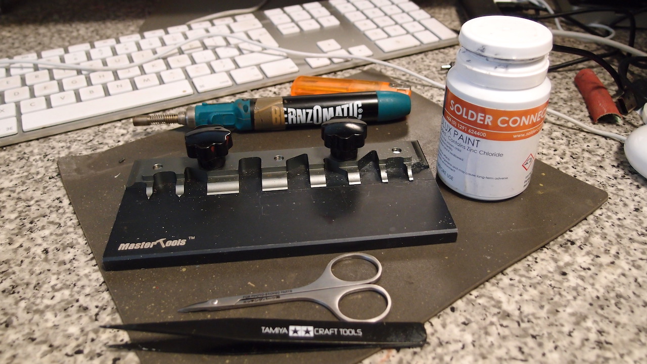

Doing some right now , no need for a review or description this is all you need. Solder a post on better. than glueing straight to the surface of the model
PE tools
PE tools

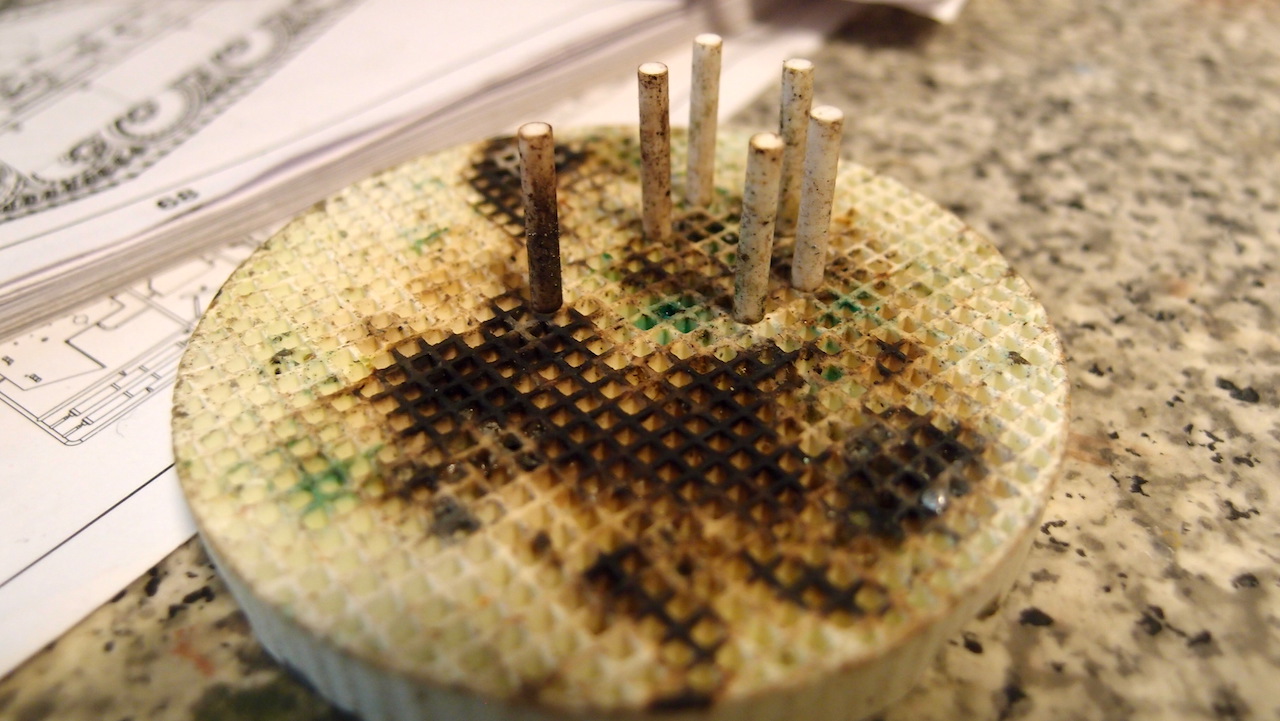

And this for holding PE as you solder up parts.
Running out of ceramic pins very fragile need to order more.
