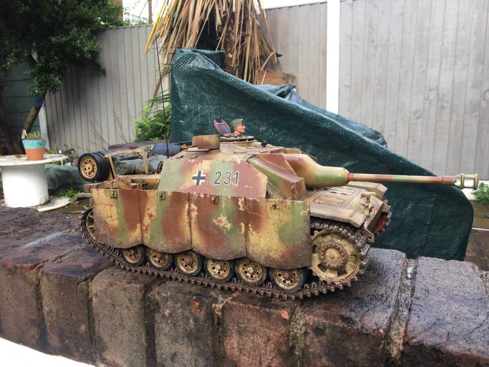

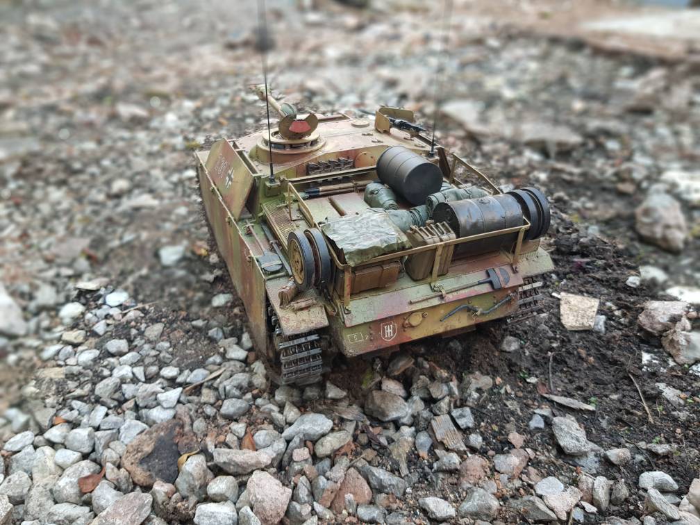

1/16th Very late war Stug III g based on a knocked out one at Paderborn in 1945.
It's running an asiatam metal chassis, metal wheels, sprockets and idlers, Taigen metal tracks. Tank Modellbau barrel, loaders hatch opened up, engine deck rebuilt to correct dimensions with metal opening hatches, transmission hatches opened up with metal hatches, scratch built stowage rack with spare wheels, gun travel lock, antenna holders, antennas, barrel cleaning rods, jack block, detailed jack and mount (jack was kit bashed to make it more accurate and detailed), atak saukoff and extra armour, working convoy lamp, detailed shapeways clamps, wooded tool handles, photo etch chequer plate, scratch built remote machine gun with aber barrel. Hidden IR emitter in the driver's hatch, scratch built spare track holder, Tank Modellbau pendulum skirts, custom painted figure (figure from Mitsubishievo on eBay), loads of stowage from value gear and Tom's bits box, the tarps were made from lead foil, phew think that's everything.
It's controlled by an IBU 2 with custom electrical installation, speaker and battery box.
