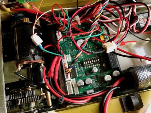

found a broken wire though it seemed to make no difference as to the running of my Taigen Tiger one mid, have resodered it still with no difference that I can tell.
Can Anyone tell me if they recognize this small plug with the red & black wires and it’s for?

I had the same issues. I thought that wire was for the barrel recoil?

It very well may be as i’m having issues with barrel recoil not working. Was actually hoping this would have solve the problem but will need to remove the turret and recheck the actuating wire and the servo as it’s still not working.

That connector supplies power to the airsoft recoil unit from the main switch. It should look like this:
- Taigen Tiger 1- early production- with barrel recoil fitted
This is actually an early production Taigen Tiger 1, to which I added the accessory metal turret with servo barrel recoil (normally fitted only to their mid-production models).
There should be an adaptive harness (from the switch and battery) which plugs into the motherboard main power socket, a strand of which then links to the red/black plug from the airsoft gun. Without it, the barrel recoil won't work, as it won't have a source of juice.
Hope this helps.

I see you have the mid-production model there with the latest V3 control system. Your tank should have the revised switch wiring that connects to the plug that's puzzling you.
