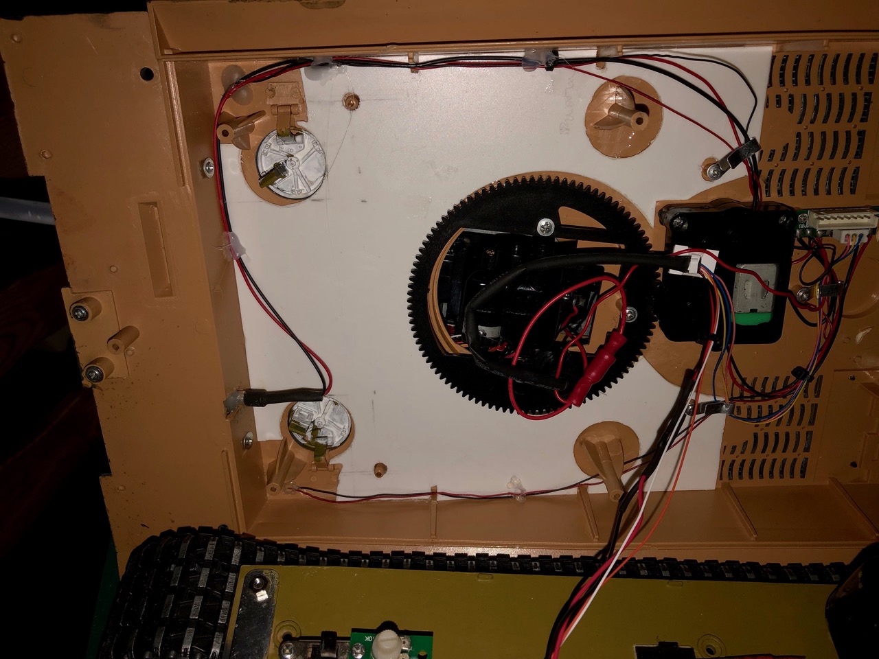

If you look at 'Step 6' of the Airsoft wiring for 360 deg turret I posted, Gary, and Chrizh, you'll see that the white/orange connector goes into the 5 pin terminal on the Motherboard. :thumbup:
Right, you put the two pin plug on the two left-most pins in the five pin socket, or he PMs me and I'll send one of these. It plugs securely into the five pin, and it's a lot easier to connect the two pin to the little socket, instead of jamming it into the five pin.
43rd RR
It would be great if you’d post a picture of the inside of the upper hull you reinforced the next time you chance to open it up , like to see how you made your cuts and fitted the plastic sheet.
Larry
As per your request:
This was taken in low light conditions, Larry. I have a brilliant wee hole cutter now, but at the time I cut the plasticard sheet for the Tiger, I didn't. Still, the card reinforcement works well.
Metal turreted Tiger reinforced with plasticard sheet.

Re: Need a answer
Post by Ragnar »
Nicely done! :clap:

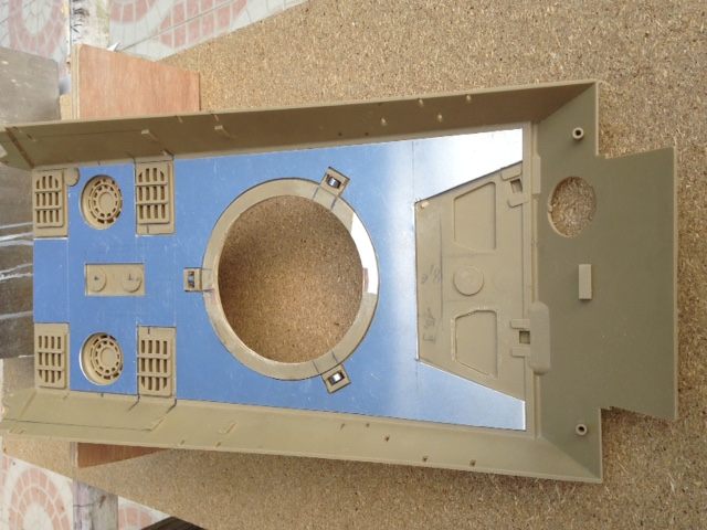

I wonder if the brace from the King Tiger could be adapted?
Jofaur86
Posts: 1665
Location: Centre France
Re: Need a answer
Post by Jofaur86 »
Hello :D
Yes fesable,on a KT Tam. Voici what I did on mine,aluminium 1.5 mm

Post by Max-U52 »
I like that aluminum plate. Very clean looking job. I'm going to ask Eric for some of the braces from the KT and the panther to see if I can adapt them to a tiger. We'll see what happens.
