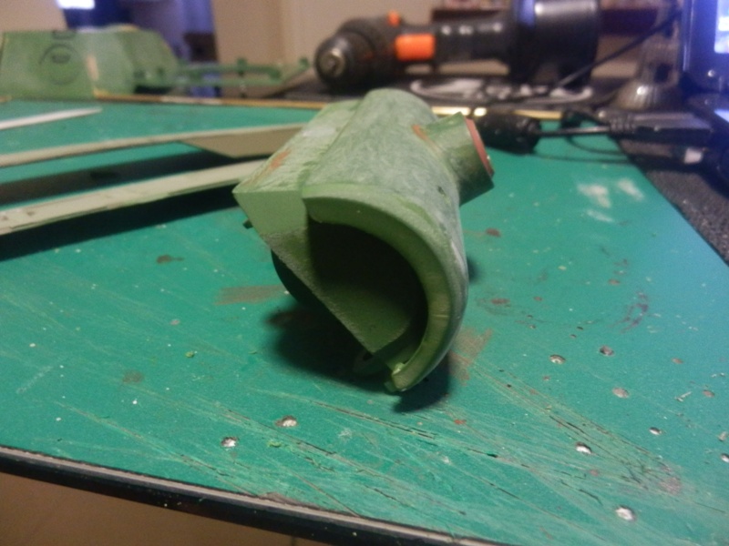

Newly inspired by Mr Raminators timely reappearance, I have managed to get a few more bits completed.
The rounded mantlet is now fully profiled and ready to refit into the turret.
It needed a bit of creative licence to secure the outer mantlet to the turret mount, but its going to work.

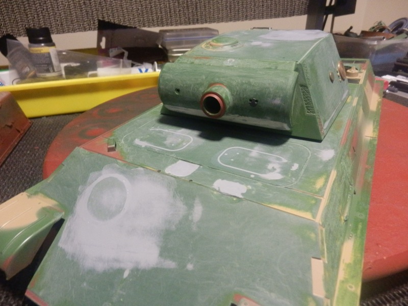

The turret has had its redundant orifices filled and ready to be smoothed over.
Even used a section of Pantiger drivers roof material to fill the carved out cupola hole !!

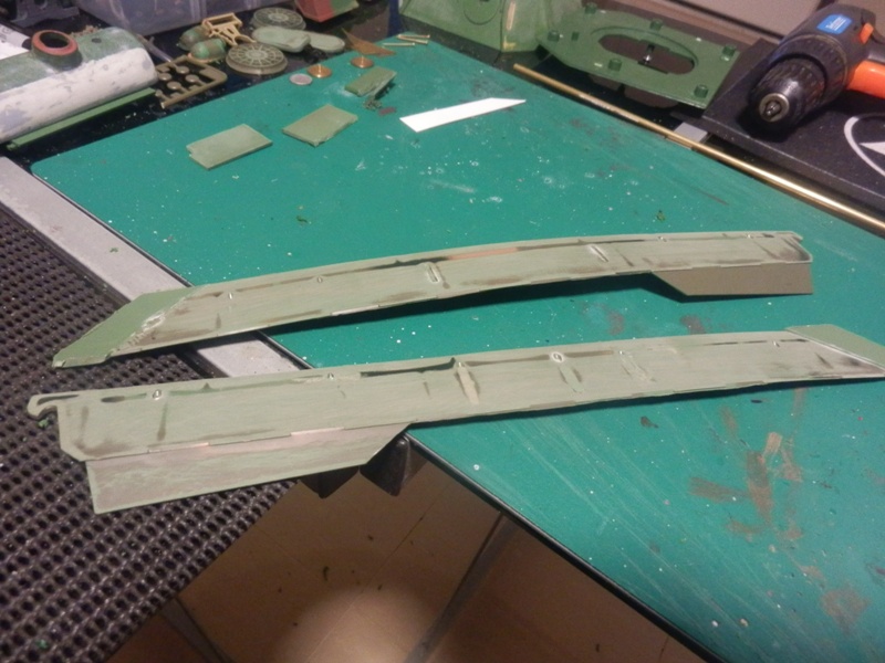

Ive reclaimed the hull sides off the poor Pantiger & after a loooooooooot of dressing, reckon I can successfully reuse them to represent the interlocked plates on the sides of the D Panther.
The front sections have been extended using Pantiger detritus which is very tough & ideal for joining other H/L material together.
Once I've got the upper hull filled & sanded , I will glue the side panels in place. The vibration of the sander might affect the bond so Im leaning towards caution.

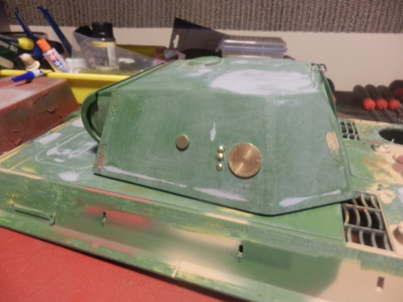

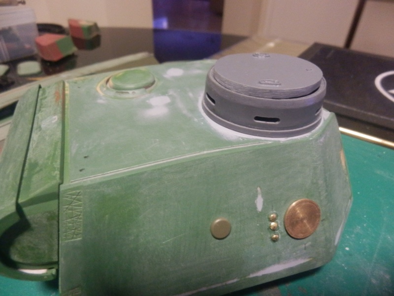

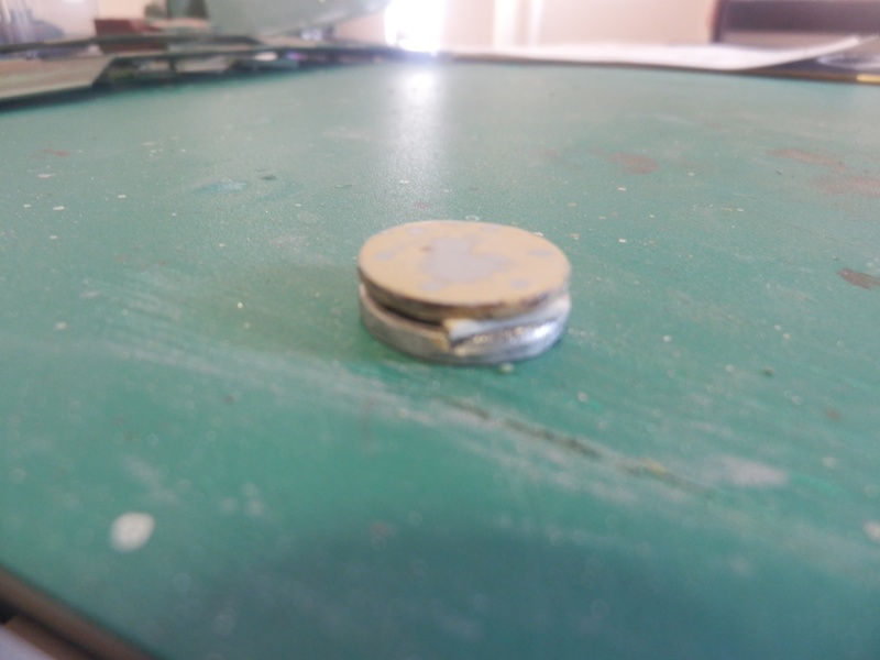

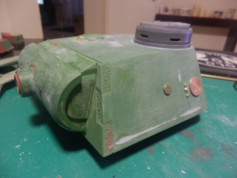

Turret and mantlet have now been mated and the communication hatch, its hinges, and the pistol ports added.
I used a spare base plate from my Panther Zu Fuss build as the hatch, some Trumpeter T34 suspension caps for the pistol ports, and picture hanging brass nails for the comms hatch hinge rivets(these are slightly big, but once the zimmert is applied will be largely hidden.)
The unique 'D' style cupola is on the way from Newcastle(thanks Mr Raminator) so the turret is going to be close to right.
Weld texture and zimmerit to do. The dove tail joints will also be recreated, even though they will be covered by zimmerit.
The hull sides are prepared, the various removed fittings have been puttied up & sanded, now the side plates will be attached as soon as I can get the time to do it without being rushed.
Engine deck is fitted out with the early grilles, and once the side plates are on, I will do the drivers roof plate bolt pattern & the hatches.
Ive made a representative ventilator out of a king tiger turret vent cover, and a Tiger 1 turret ventilator base. As its hidden by the barrel lock, theres no need to be super fussy.

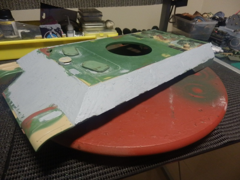

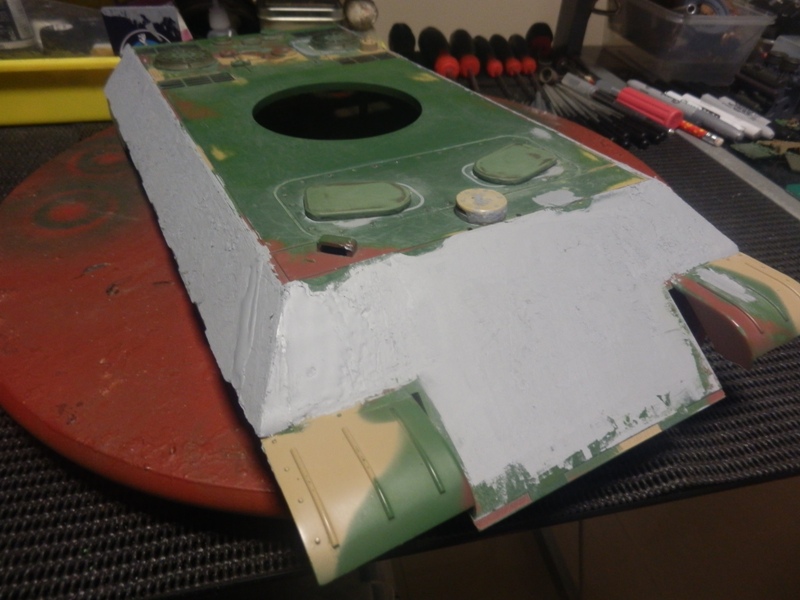

The side plates are on.
Front infill sections are in and the whole lot is covered in Tamiya putty.
Driver and MG/Radiomans hatches are secured, just waiting on handles once all the mucking around with stuff is done.
Once the side plates are filled with adhesive I can complete the rear plate infills and get the over all hull work finished so the dozer blade mount can be started.
The pannier boxes are almost done, but to get them looking right will be left until the whole hull assembly is joined together.

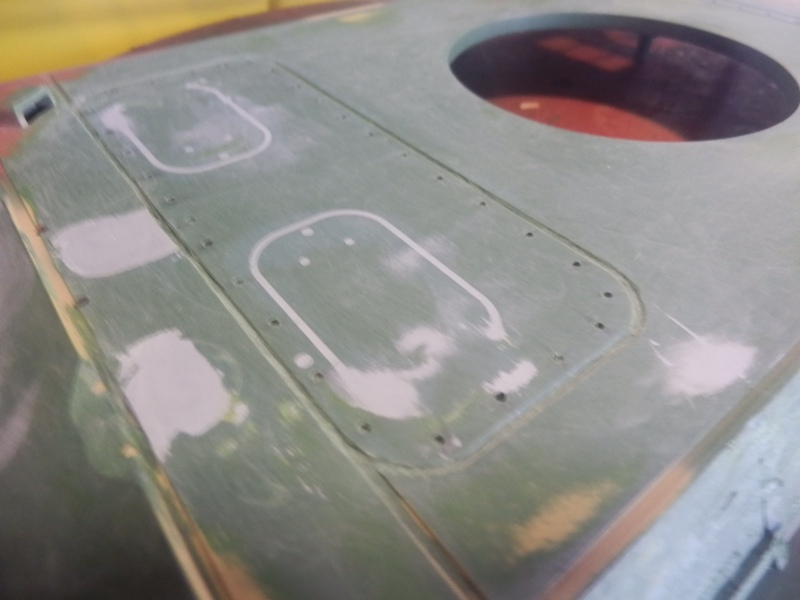

Drilled the drivers roof plate out and used dress making pins super glued in place to mimic the bolt pattern.
No real reason other than to make it near enough to look at.
I've made the drivers vision block cover and the old style M.G. slot armoured shield that can be secured once the front plate is sanded & evened out.
No point in making either of them operational, as long as this thing can push a descent load of stuff ahead of it without issue, thats good enough detail !!
This thing has soooo much to do on it just to get an oddity its mindbending
