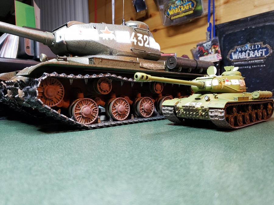

So l decided to loosen the track tension on my lS-2 so that it looked like a real one that had just driven out of the show room, a little track saggy!
The two 2.5mm hex bolts need to be fully removed to release the idler hub from the front hull and the hub can then be gently prised away. Whilst its in the hand, l removed the 1.5mm grub screw that retains the stub axle and lubed the shaft.
At this point the hub can be replaced and twisted to a new position. The shaft on the hub is many multi-sided so you can select your preferred level of slack and match both sides accurately. The pic below can be mirrored with several real IS-2s but it's a bit more than l want - I'd prefer my tracks to stay on!
This is how l finished up, realistic yet practical. The whole procedure took about 5 mins.
