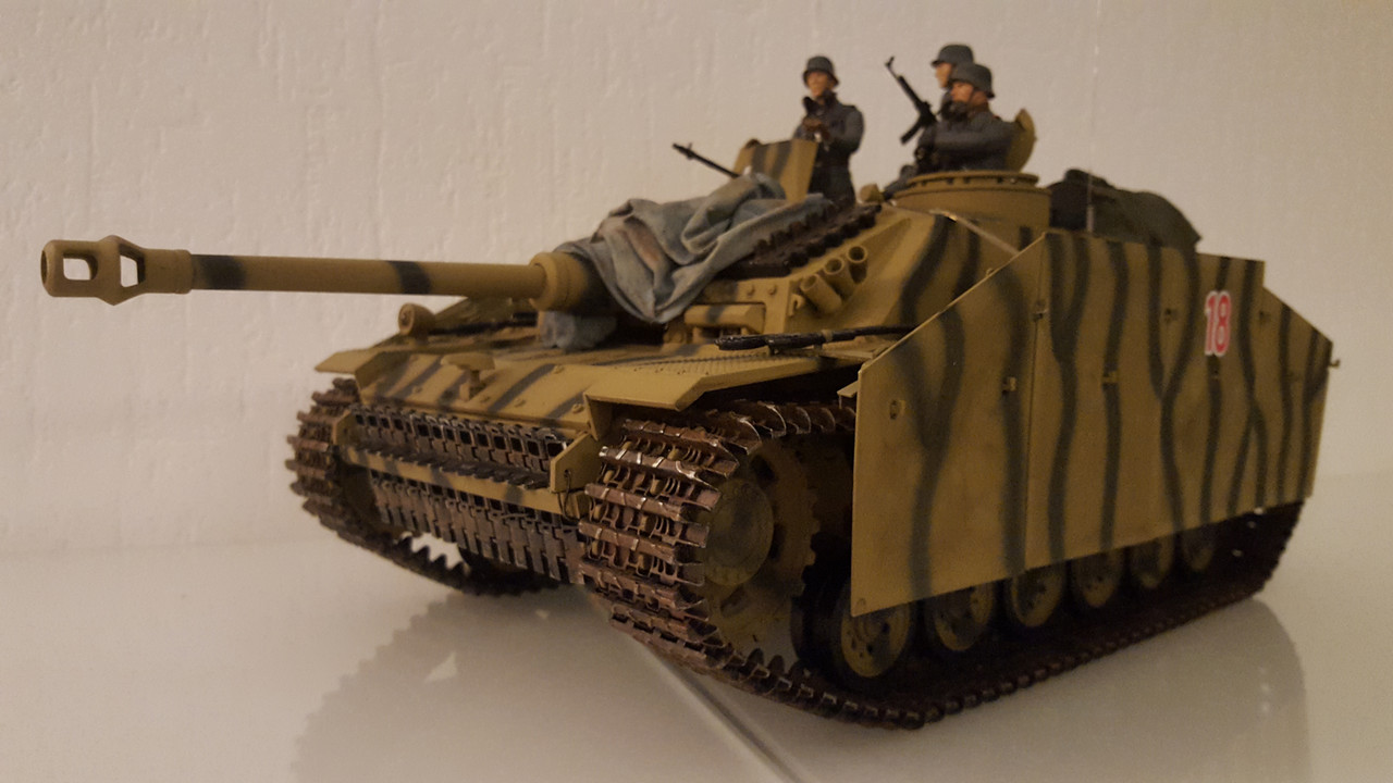

That looks great Rob :clap: I love the look of the Schurzen on the stugs, I've been contemplating getting a set for mine for a while now and looking at this may have just sealed the deal :thumbup:
Cheers, Lee.

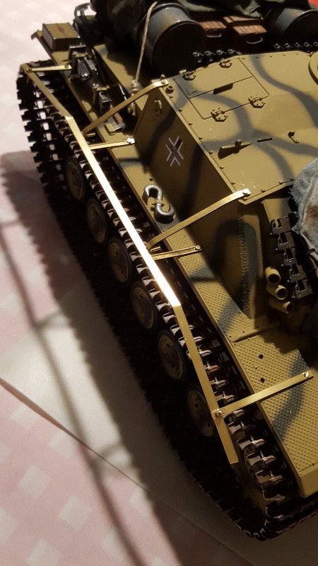

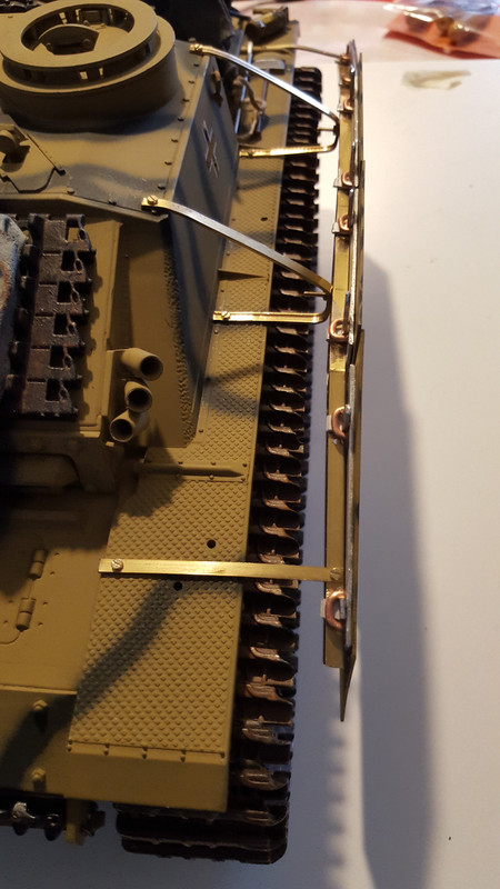

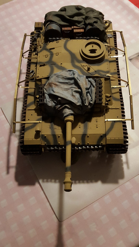

Schuerzen are made of Polystyrol.
They do come with the brackets and hangers available at Tankmodelbau in Germany.
But because I added the wider Ostketten to my StuG, the stock brakets/hangers do not fit.
So I made it all from brass. I used U-Profiles 1 x 3 x 1 mm and angle profiles 4mm alongside the StuG.
I also have aluminum plates of which I could make the Schuerzen too, but for now these will do.

Here you go.
Attached the brass stuff onto the Kasematte with 1.4mm screws and nuts....almost drove me nuts.....!
