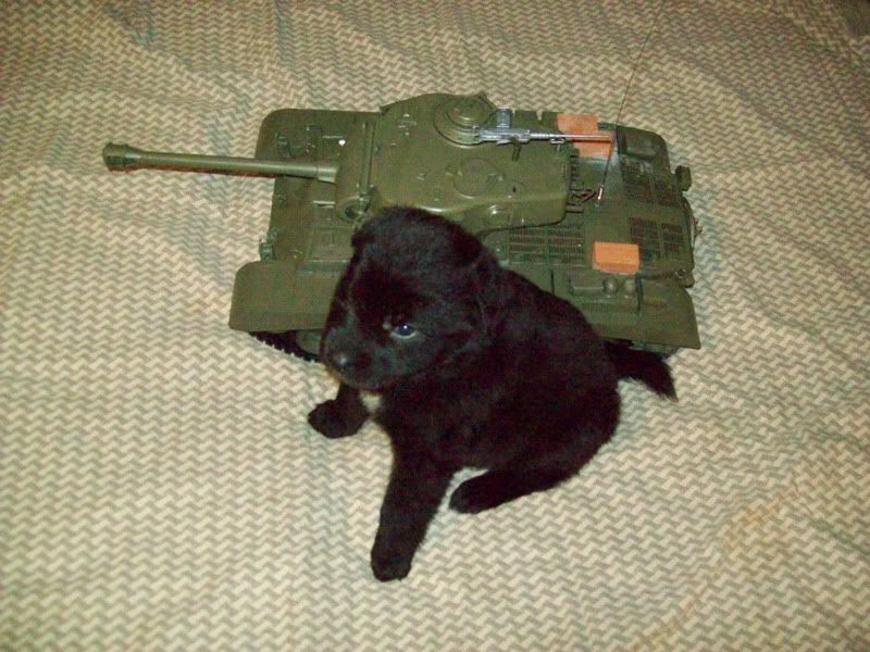

As for the other Kitty Killer, its a HL M-26 Pershing S&S with metal tracks & gearboxes. It has the distinction of being my first 1/16 tank. I bought it from a stateside dealer. A few of the fiddly little bits broke in shipping, but it doesn't bother me. There were a few curious things though:
1) It came with the proper stickers and .50cal MG/Mount for the pershing, but came with a solid green German Commander(The kind with the hat like a baseball cap). I prefer the look of tanks buttoned up so that doesn't bother me the slightest.
2) It had an RX-18 in it which surprised me. I thought only the new stuff(Stug/Jagd) had it so far.
3) It had factory installed metal gearboxes, this isn't what surprised me as I knew it was coming with them. What surprised me was that they had absolutely NO grease on them. Which wouldn't be so bad except the local shops don't have any grease in stock and the soonest I could get some delivered from an online shop is July 7th, so I can't drive it until I receive that package :'( Atleast I have a puppy to play with in the mean time.

Don't worry about running the tank without grease - it's actually a good idea in my experience to run them in dry because the teeth are cast, not cut so need to bed in - the motors will then run cooler & the RX 18 last longer.  I've run all of my tanks in 'off load' by removing the tracks and running for an hour on a model train controller.  You could achieve the same by chocking up the body and using the battery - it may take a couple of recharges.
Petroleum Jelly is a good alternative to silicone grease.
Lets see how adorable your 4 legged kitty killer is after he's chewed off the barrel of your tank or watered the electrics!!
