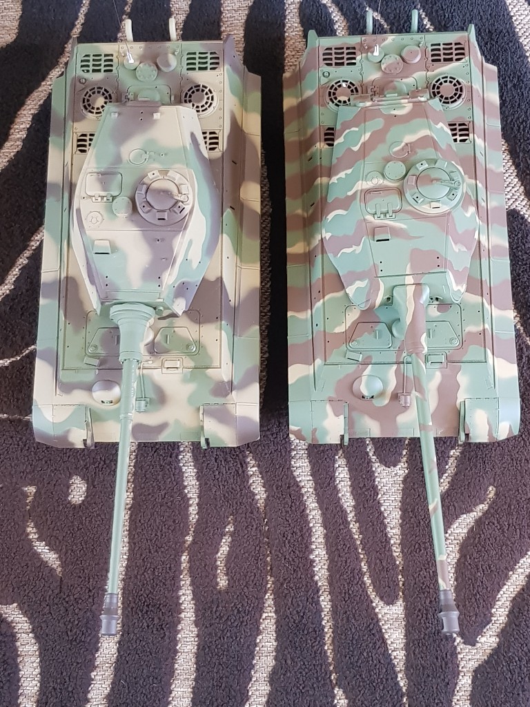

Hi I've just joined the forum and have 2 HL King Tiger's which I have just also bought. One is the early turret and the other one is the full production turret. They are completely standard at the moment and not even put the accessories on yet. The early turret has developed a fault and the turret in it turning properly,
but I'm planning on modifying things so it's not going back. I want to change to a Clark TK24 electronics and do zimmerit and some better decals for both of them.

Ok it's probably not the best place to take a pic
