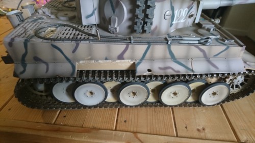

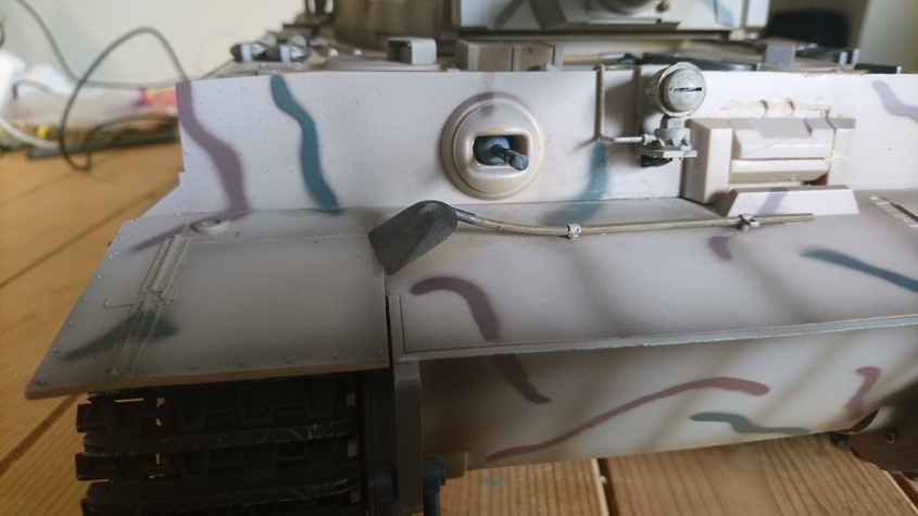

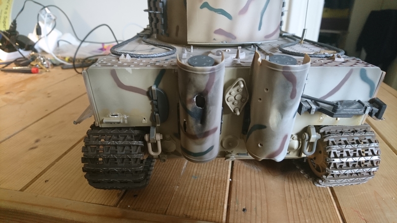

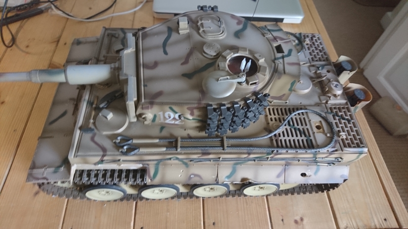

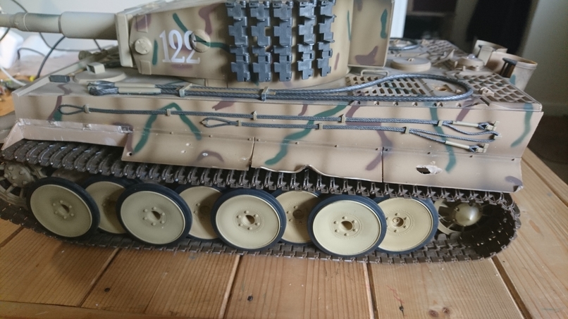

While I'm waiting for the bits, I've cracked on with a few initial body mods to get me started. Quick view of the side, starting to damage up.Opened up the commanders hatch, need to construct the MG rail and sort the cupola out. Side skirts damaged and one removed.Load of fittings to remove, but that's for another day. Exhaust covers damaged,centre of the exhausts drilled ready for the smoker. Mudguards off, got mato metal with hinges on the way. Do I do the convoy light as well? More skirt damage & removal here, aerial relocated ready for Dave (Forgebears) aerial with rubber base to come. Two holes at the back to sort from the old aerial mount & an led. Right, for the time being I've got a HL LED mg in the ball mount.Ain't brilliant, but does for the time being. Coaxial mg deffo needs sorting as its a tiny thin fibre optic tube.As does that shovel.

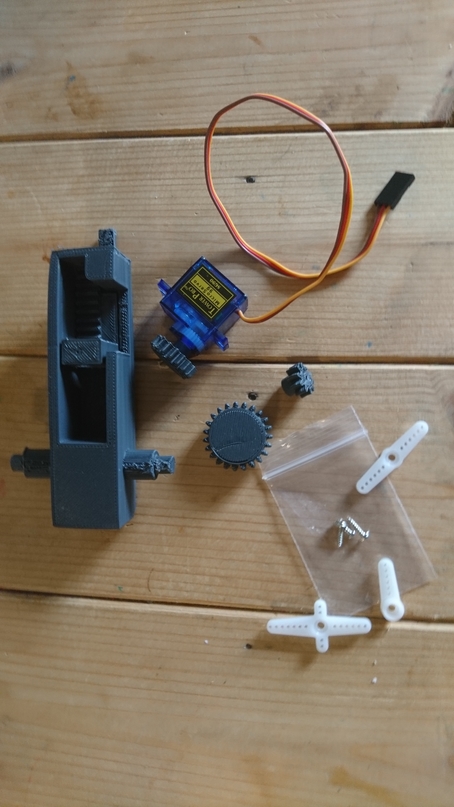

Pressies in the post, the servo recoil unit from rctankelectronics, nice piece of kit, but I've realised it'll be easier to get the servo elevation kit as well.

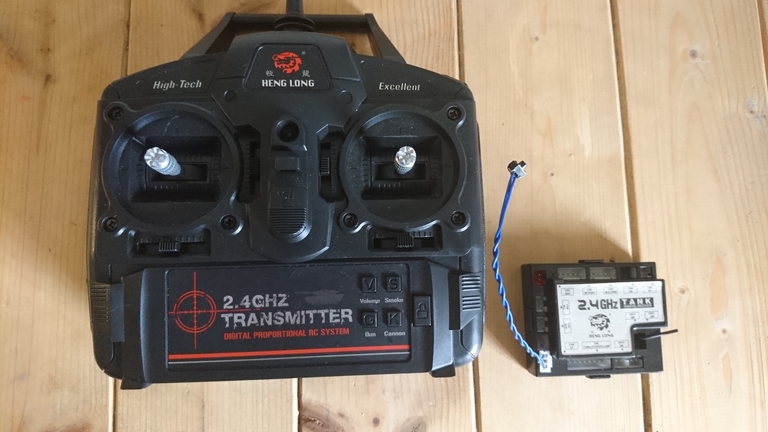

HL 2.4 setup. This is the first of my silly questions, the rx doesnt look to have a socket vor the volume control, secondly sounds. The wsn has sound already, what do I need to get sounds on mine, ie what extra bits do I need, or are they nickable from my doner HL or the original WSM?

When you can get a gear ring section you wont need the elevation kit. Just glue the section to your unit and put a servo on, et voila.

Cheers Soeren, thanks mate, hopefully I can do her justice! I also owe Dave (Forgebear) a big cheers for the helpful info from this morning, the query around the 2.4 setup now sorted, looks like I'll be doing a rethink on the recoil and elevation, plus is I've two good elevation units to use, just got to do rebuilds on the recoil units to get them playing possibly.. If that's the case I'll have a servo recoil/elevation unit going spare....On shift now until next Monday, hopefully I'll have a load of happy post waiting for me..

Bear in mind the H/L electronics system you have wont operate the recoil.
Thats ok to get it rolling, you can always revisit a better control system later on.

Thanks Herman, now thinking if I can tie the WSN recoil into the cannon/fire option on the HL 2.4...

or use the taigen turret infared on it
