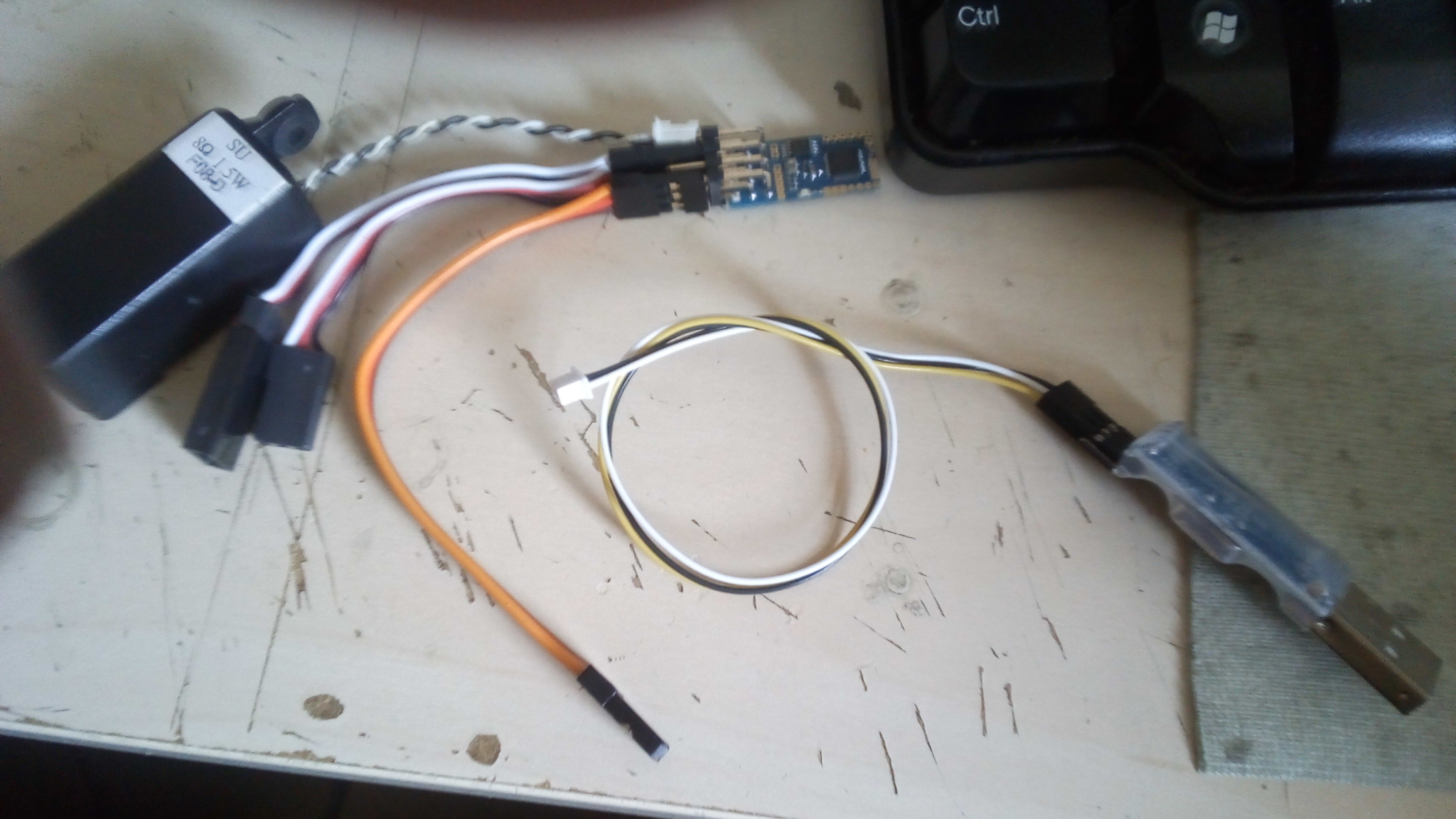

Added a pic, no idea what the orange/red/black lead is for, or where the programming USB link goes? I don't want to solder pins onto the board in case I have to return them.

Ok great. Anyway I just took a look to the image you posted, please, again, read my tutorial and watch the videos, read carefully the manuals too. I am sure you did it, but please do it again, it will save you tons of frustration in an already complicated thing.
If you read everything I think you will see that the orange red and black wire is for triggering two extra sounds in an easier way than scratchbuilding an encoder or 12 position switch in your radio and doing some wizzard programming. In my P40 warbird I have set it for triggering the machine guns and another extra sound, but you can program whatever you want. At the beginning you can skip it. You will have time for it coming back to it.
Regarding where to plug the programmer, again I already explained in the tutorial. Maybe that programmer came bad wired (like many, included the one I got) but again the solution is in my tutorial. Also be sure of installing all drivers in your computer.
Dont worry about having to return the board. All those guys in aliexpress/banggood who say the board does not work, is just because they dont know how to use it. At the beginning is a tad complicated, but Im sure you will get it running. Is unveliebable this board is so powerfull. No need to solder anything to it unless you want it.
Bridging the two contacts is for configuring the throttle endpoints. I think I have to do a videotutorial of that too, but also in the manual is explained very well.

Still can't get sound, but while trying to get the USB to talk to the pc and the sound board, I checked the wiring...and sure enough they have got them in the wrong order on the DasMikro end. This means that anyone who has bought the Bangood programming unit with the lead will never get it to work.
Once I have resoldered the wiring, I assume that I will be able to see whether the sound files have been preloaded.

Just a question. Are the sound board Tx, Rx, GND pins shown in the pic on your thread in the correct order? I have just swapped the wires over on the DasMikro programming cable but maybe they were correct originally?

My diagram is absolutely correct, but it is not mine. I just found it in internet, because somebody was unable to connect the board to the computer too. So that guy did the diagram and uploaded it to banggood. I took good note of it, and I did one following exactly the same instructions and worked flawlessly. My programmer came bad wired, thats 100% for sure. Also the diagram does not mean you have to follow it and do exactly the same! It depends about how your usb connector is. I dont remember now, but probably in the dasmikro usb you can read what is every pin. What means is not the order of the wires, but the match of the correct pins!

The only way that I can get the USB to work with the DasMikro board is to leave the yellow/white/black as they are when standard, but just make sure that the JST plug is around the right way. Mine was delivered with it upside down, which reversed the two outer wires at the other end.
