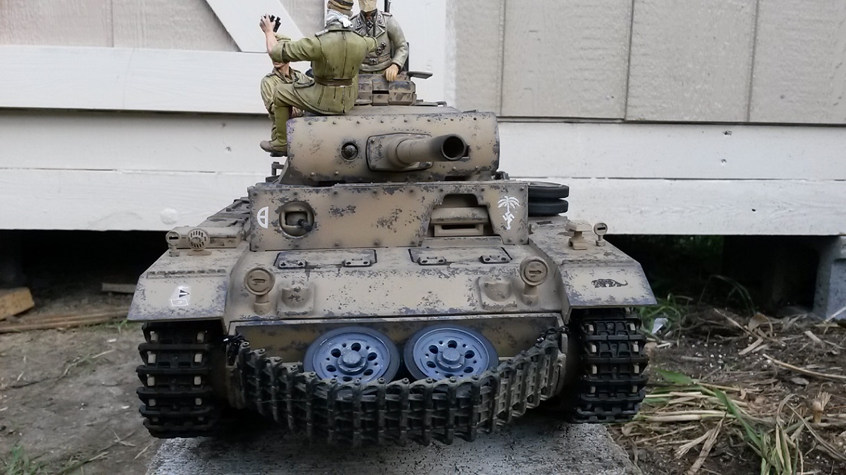

So anyone going to post a couple of pictures of the road lights filed down with the covers fitted?

by capt midnight
I use a hole punch that I borrow from the wife. She got it for her jewelry hobby and doesn't mind to share. I punch the discs out of sheet copper, then cut the slit in them with a thin cut off wheel. A bit of clean up with a jewelers file and Bob's your Uncle!
I glue them on with a craft style white glue that dries flexible, kind of like RTV.
Bill

Outstanding job captain midnight, on the lights and the paint job

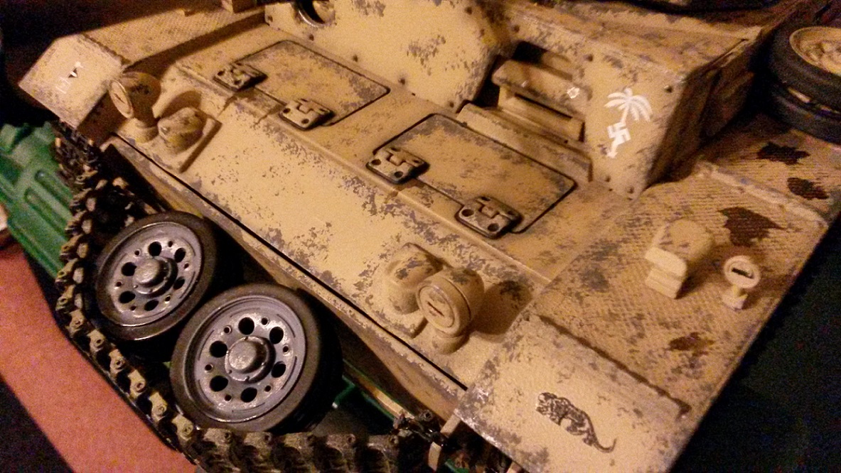

Oh-oh-oh and where’d you find the Afrika Korps insignia

Ragnar wrote:Oh-oh-oh and where’d you find the Afrika Korps insignia
Those came with the decal set I picked up for the Pz III. I also got a set of these...
https://www.ebay.com/itm/Peddinghaus-1- ... SwNSxVMopb
There's 24 of the palm tree markings on the sheet. Dragon hobbies is located in the states and ship pretty fast. Just keep in mind that the Peddinghaus decals are printed on one continuous sheet. You'll have to trim them close to the printing to avoid an excess of carrier film.
