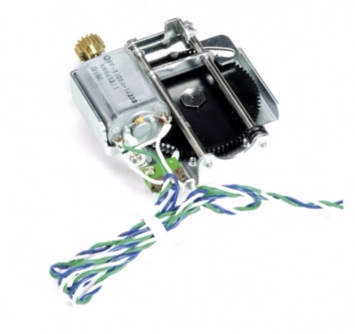

ronnie42 wrote:
The attachment P4040084.jpg is no longer available
Charged a battery, wish Tamiya went down the lipo 3c route like IBU and Elmod where you can dial in battery type and voltage. Recoil is 35/36mm lines up with 1st groove. Wonder if recoil is voltage dependant , new charged battery giving max recoil?
If you look at this pic of the recoil unit (they all look alike, irrespective of Tamiya model), you'll see that the travel limits are determined mechanically by gearing and end stops; not electronically.. :) An increase/reduction in electrical power could only affect the speed of the recoil, if anything.
Typical Tamiya Full Option recoil unit
