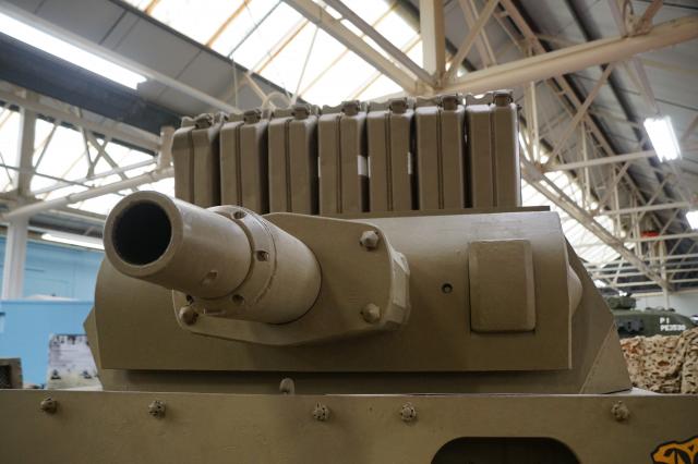

This is a Panzer III at Bovington.
The accompanying information board did say that the cans would be removed before the tank went into combat.
