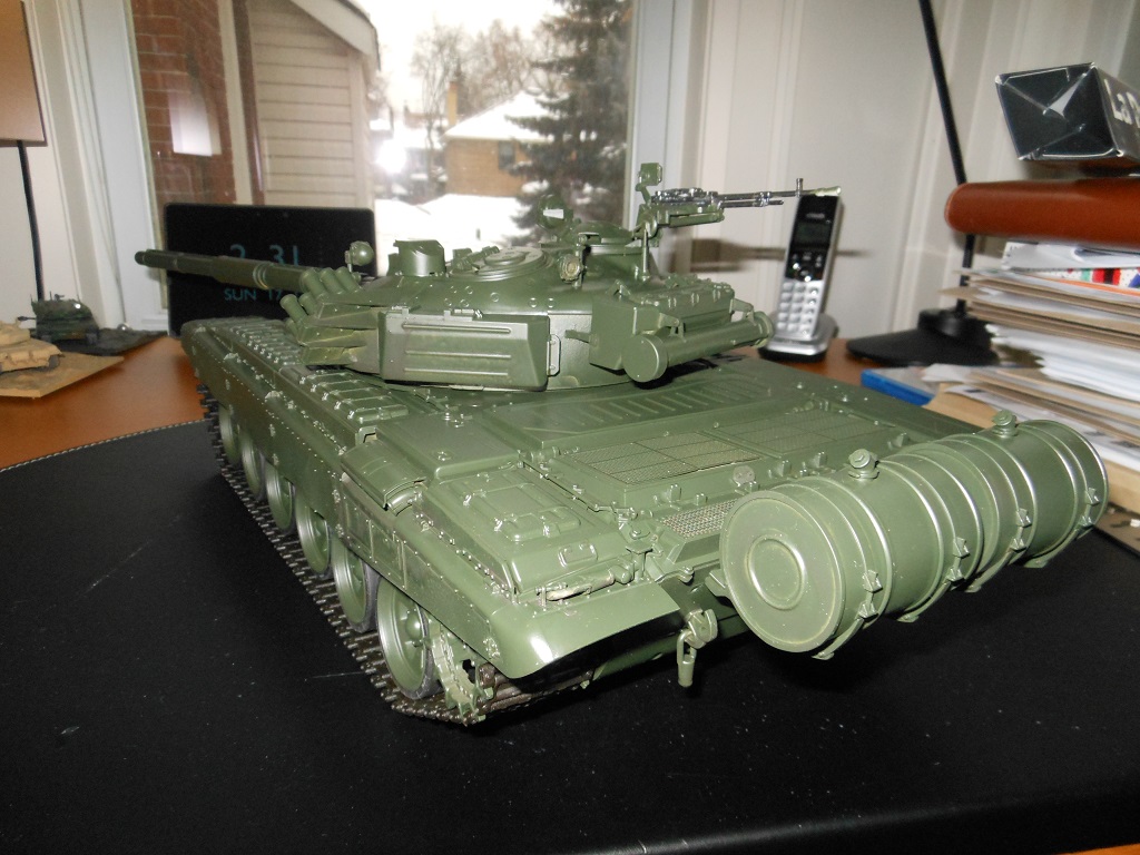

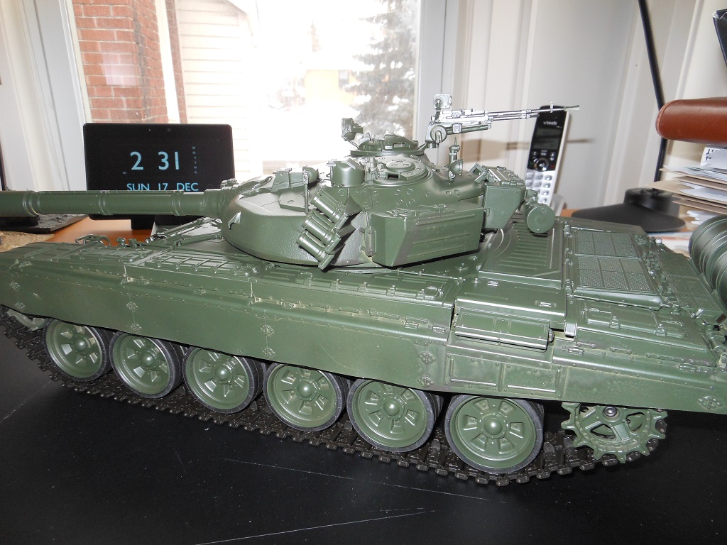

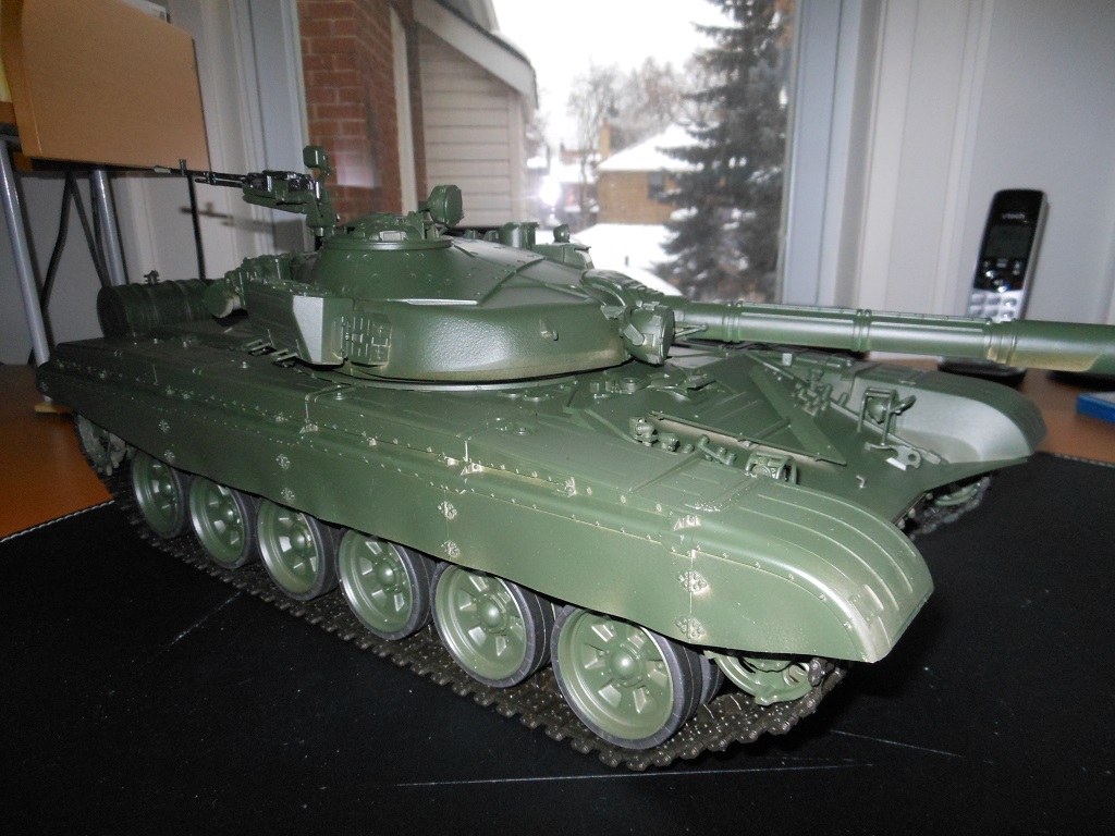

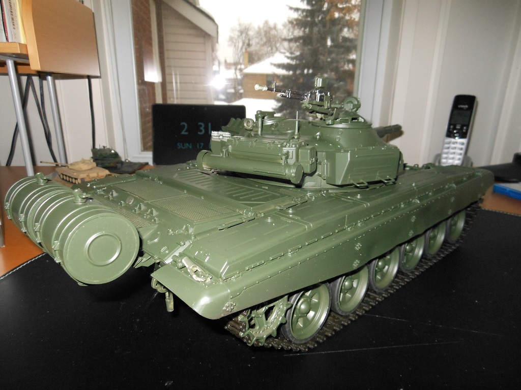

Another Trumpeter RC conversion after the M-ATV MRAV......... The Trumpeter T-72B has all the hallmarks of an RC version soon (mount for speaker on the rear deck, screw mounts for the upper/lower and turret, mount point for gearbox, rotation etc etc). I choose the Heng Long T-90 (which is basically a soup-up T-72 anyway) and it fits quite well with some minor shimming. I did choose the Trumpeter road wheels as they actually have soft rubber rims on them.
Still need to paint the black skirt and also fuel tank hose and log
Tamiya Dark Green base colour. TBU base in the commander's cupola and IR emitter in the Gunner's shielded sight

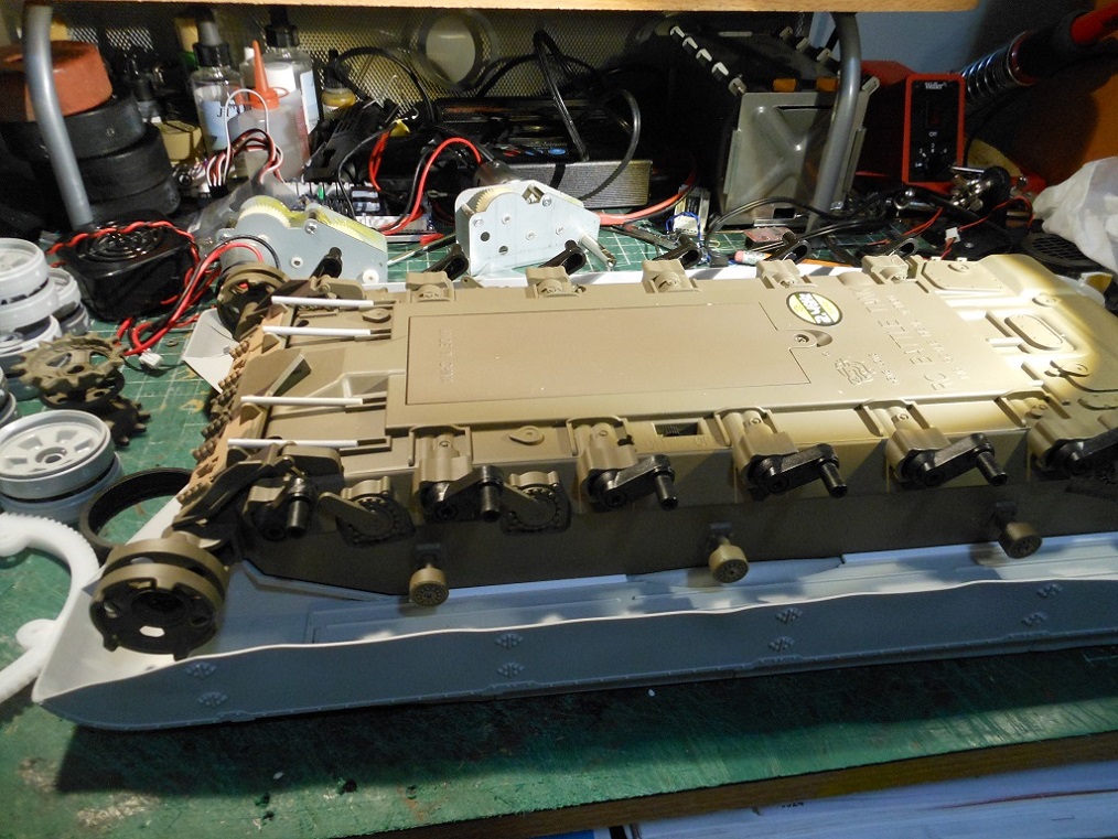

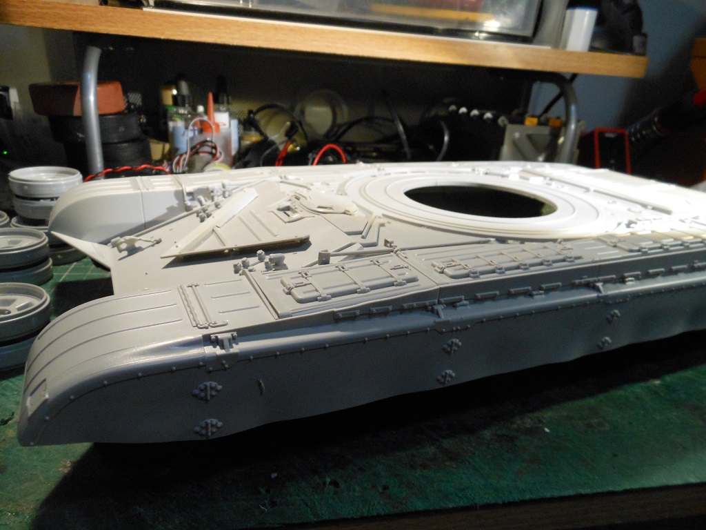

HL T-90 lower with upper shimmed to fit

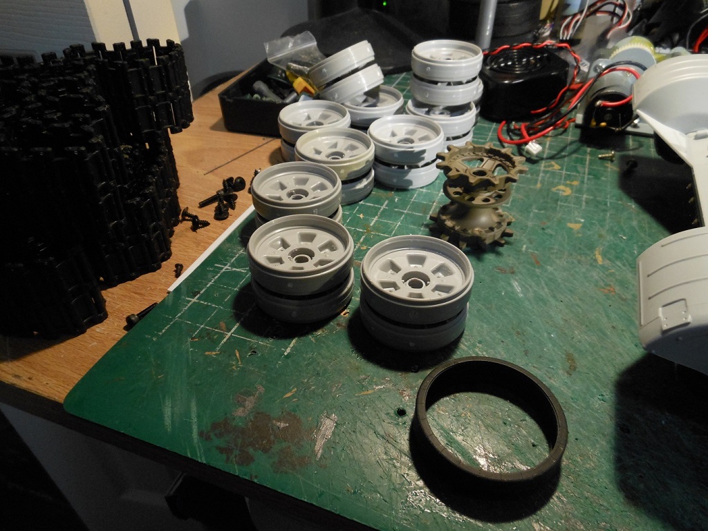

Trumpeter rims are just as solid as the HL plastic ones but with soft rubber threads.
Grafted Trumpeter back plate over the HL one for a better fit

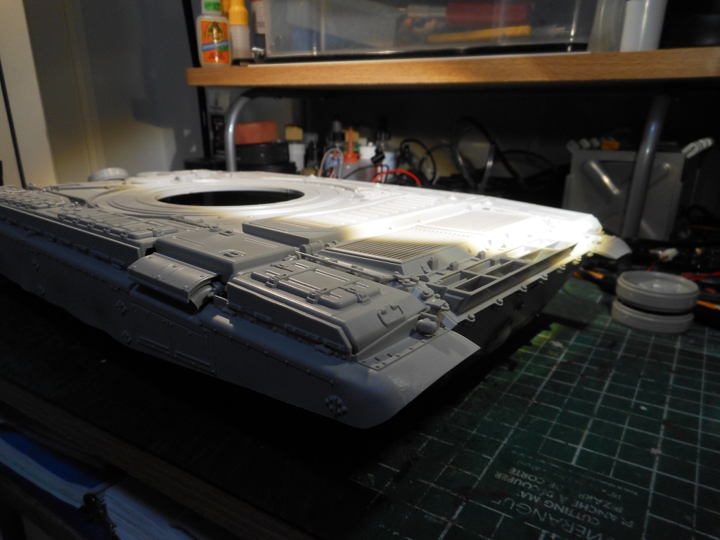

Trumpeter upper fitted over the HL T-90 lower

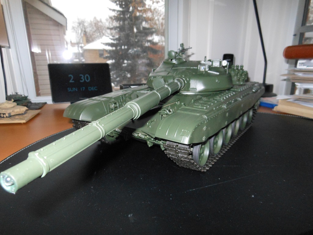

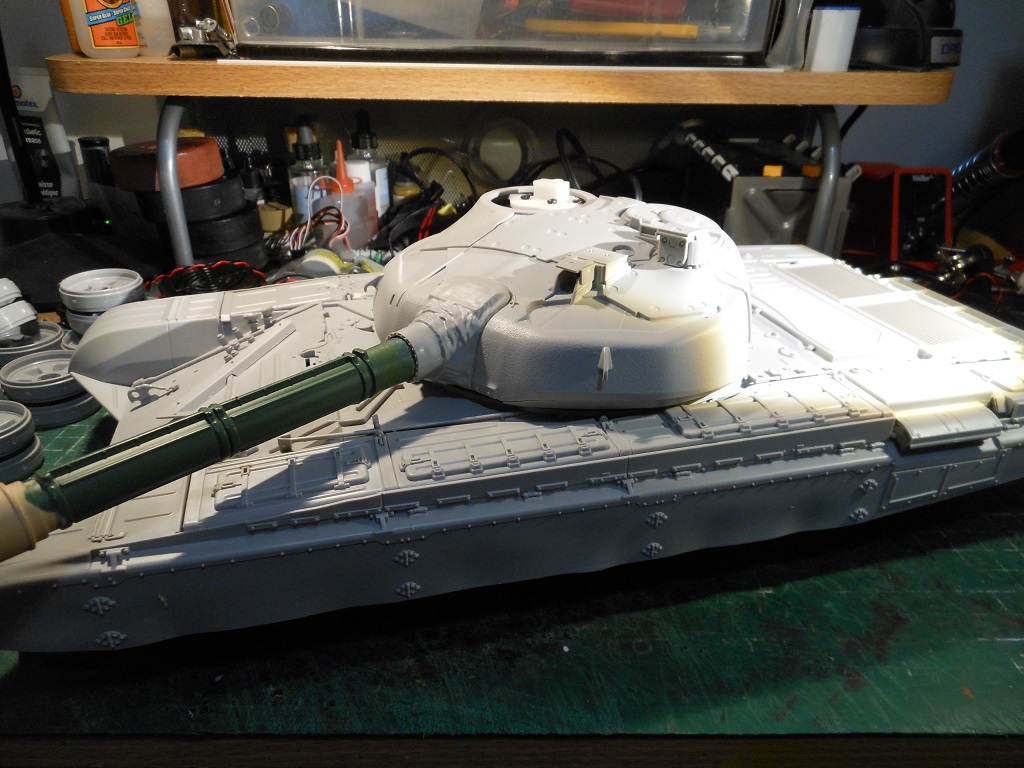

Trumpeter upper and turret with a HL ZTZ-99 barrel install with recoil. Recoil unit is a modded Jarlath unit.
