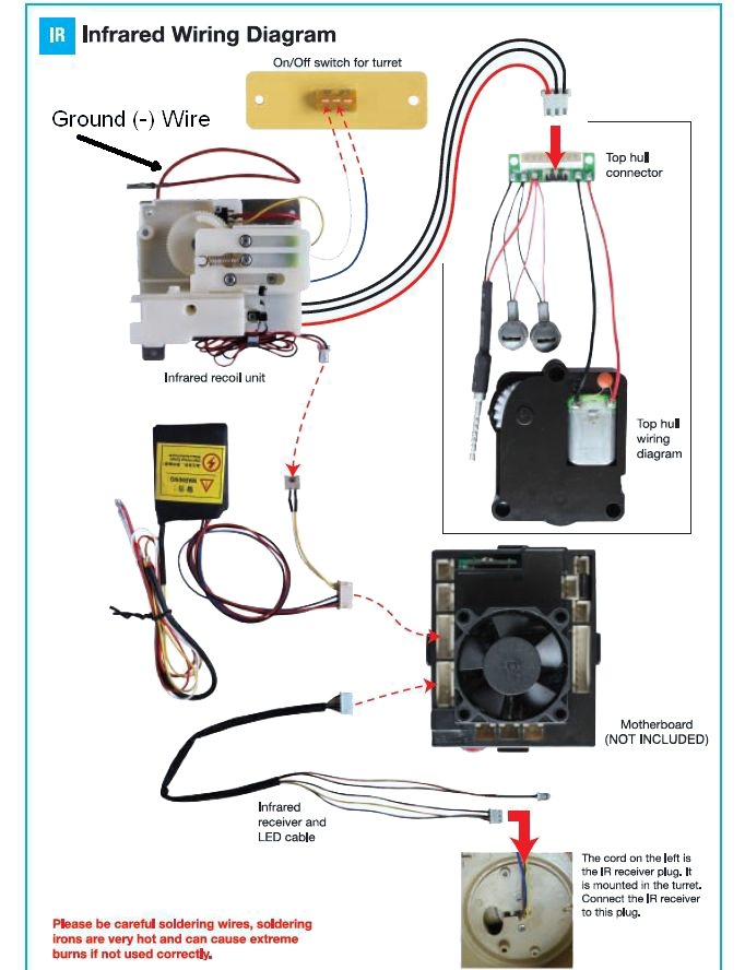

Hi all can someone tell me that iv got a Mato tiger 1 with the B.B. and no recoil
But I won’t the recoil with flash unit. If I buy a Taigen plastic turret with flash and recoil in how easy would it be to swop it over and the electrics to my Mato tiger thanks for any help leadfoot

Here's the wiring diagram for HL/Taigen IR /Recoil version of the Taigen turret..for you to compare with the Mato wiring. Bear in mind that Taigen have revised their electronics recently to V2. It's a much improved system allowing hobby grade Transmitters to be used for the first time, and offering much better sound effects.
Heng Long Taigen IR wiring diagram

I have the turret with airsoft barrel recoil, and BB. If it flashed too, that would be about perfect, but it doesn't. That said, it's a massive improvement on BB with no recoil.

Another option would be to ditch the Mato upper hull and turret and go for the complete Taigen unit http://www.taigentanks.com/taigen-parts ... /tag120062. That way, most of the wiring will already be in place...but you'll still have to connect it to Mato's MFU (Multi Function Unit controller)
