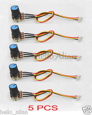

Bought these, supposed to be rated at 10k, wired up to a torro board to test and is very loud, connect up to a clark
tk24 and is very quiet, works fine with standard HL volume control, any ideas anyone.

Hi chaps, I have swapped speakers over 4ohm and 8ohm and no real difference, tried the new volume pot in my
torro panther which also has a tk24 and again went very quiet, will go through all 5 pots and try them out tomorrow.

Tried all 5 pots today and none of the above works properly, that's what happens when being a cheapskate and
ordering from hong kong :haha: :haha:
will try and source one from the uk and try that, I assume it is the 10k pot I need for the clark board ? :S

Hi carl, it says 10k on the standard pot, these were ordered as 10k but I wonder if they are not, as it says nothing
on them, a shame as they look well made.
regards john :wave:

Move red wire to middle

Hi, do you mean then to swap the red and yellow wires over.
