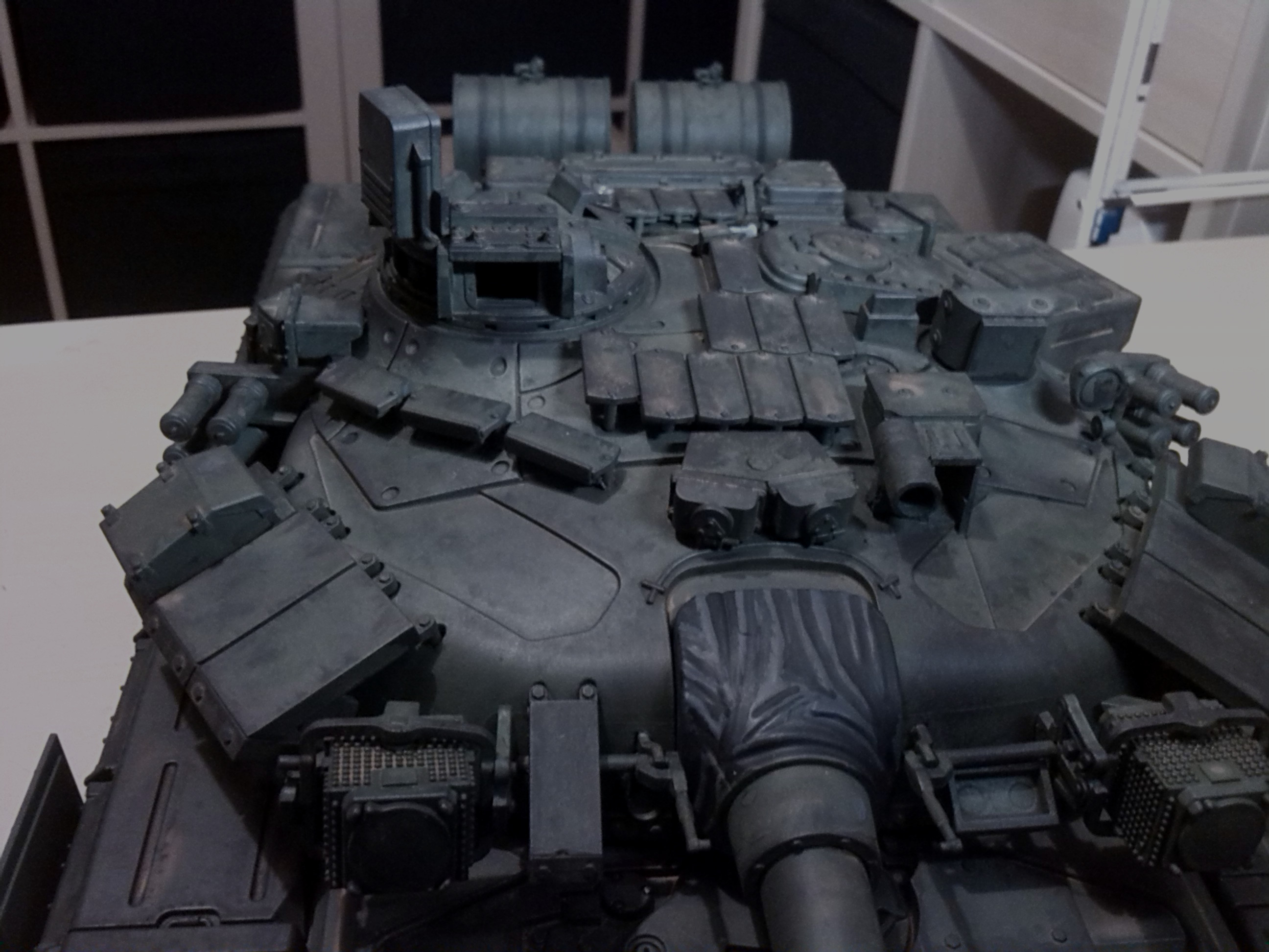

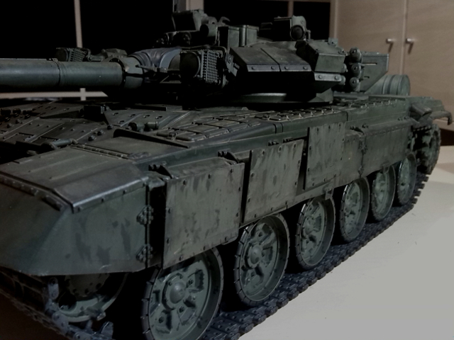

Even so I decided to go for a solid green, which of course presents challenges of its own. Fortunately even with a solid color, the tank's so big it's not difficult to really make it pop, using the tried and true drybrushing and wash techniques, along with dark and white undercoats before the main green is applied. I am still searching for the magic formula, and I am still nowhere near that yet - these photos are ones i took mostly just to look for flaws - but I learn something every time I paint. I have been building armor models since the 1970's and even now, I am still far from the results I really want! But that's what the hobby is all about after all.
Russian armor green is at least one shade lighter then US olive drab. In my opinion armor on lightly used or peace-time Russian armor would be even lighter yet just from fading. Kits like the excellent AK interactive Russian green acrylic paint set even seem to take this into account: top surfaces are recommended to be lighter then side panels and the set has several shades of green. However the directions (the pictures on the box and the youtube videos) are counter-intuitive. If you follow the examples they would have you paint lighter shades over darker ones, the opposite of what you probably ought to do. Also the primer included in such kits is going to spray much too thin to cover even molded plastic let alone any previous finish. If you use spray can primer, which I always do, even grey primer might be too dark. If you use white primer you can't go wrong.

So much better looking now IMHO I really like the effect you have achieved with the paint modulation and the green colored Russian tank is always tops in my book!

A man after my own heart, they look way better in green IMHO. Well done that man! :thumbup:
Re: Heng Long T-90 repaint in Russian armor green
wibblywobbly wrote:A man after my own heart, they look way better in green IMHO. Well done that man! Image
Wow that's one beautiful tank Mr Wibbly
Wibbly are those applique armour plates on the sides? Such a cool look for sure
Both are excellent examples of what can be done with patience, and a paint pot. :thumbup: I also appreciate descriptions of techniques and colours involved, which are useful for those of us who might be less adept, or experienced, in the daubing department :) :thumbup:
