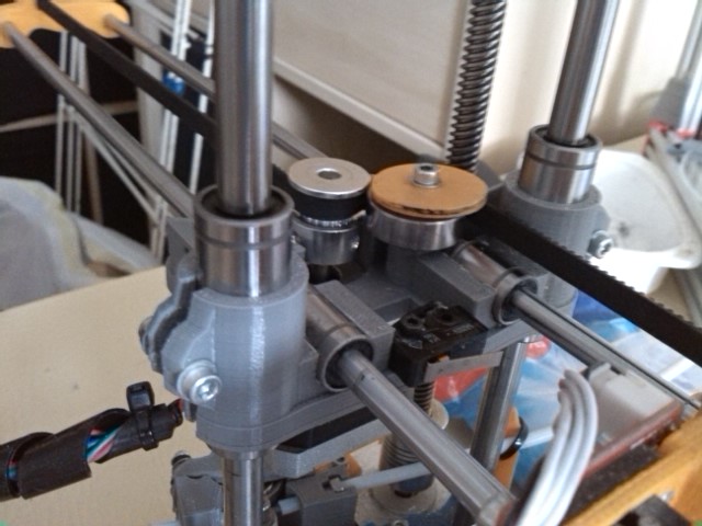

First up was my old Smartrap. When I first got it it printed like a dream, but over two years it gradually, and so gradually that I never noticed it, was not doing so well. I tried different hotends, but it still wasn't up to scratch. So, I reloaded all the original configuration files for the control board, and for Cura, the slicing program so that I had a solid start.
I went over it tightening the pulley belts, and oiling bearing and rods, and after a couple of tweaks on the configuration files it was almost back to as new. I changed the bed levelling from a 3 point prod to a 9 point but I was still only getting quality prints from the back of the build plate. Then I noticed that one of the linear bearings seemed loose, and sure enough it was 'very' loose. I checked the other three and they were all loose as well. As to how it was printing as well as it was, was amazing to say the least.
Hmmm...now, do I write and ask the guys that sold the kit for a replacement part, or do see if the printer will print a replacement part for itself. I took the second option, as 3 hours waiting was better than a couple of weeks. The part it produced was a better fit than the new one when it was built?? It took 20 mins to fit it, and now all is good again.
The other printer was a nightmare. I fitted a new hotend in there, but it was shorter than the original. This should have been a simple adjustment to the configuration file, but things just went from bad to worse. I eventually figured out that the only way to get it to accept new parameters was to find a command that would erase the Eeprom. This was only mentioned in one post in one forum that I visited. I did that, reflashed the memory, and bingo it took the settings that I was trying to get into it. Unfortunately, this also means that I will have to reconfigure a whole load of other settings as well, which is a lot of work on Delta printers, but at least I can get it back to where it was.
The joys of 3D printing. :/
