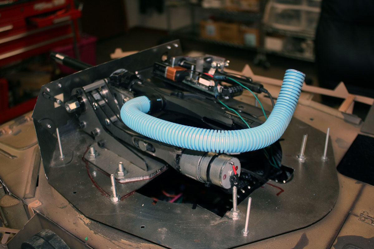

Anyway, here's some thoughts on mounting this thing in a tank. The photo theft from threads like the one Roy provided are really enough to frost ones bottom. That was probably a very useful thread before they stole the photos, but without them a lot of that stuff is already obsolete. It seems paintball tech moves almost as fast as computers, and the .40 cal paintballs they mentioned that were being tested have already been tested, produced, and gone belly up. They don't even make .40 cal paintballs anymore, and I seriously hope they always do .50 cal, and not convert everything to .68, which is by far the most popular caliber.

You might be interested in this Guy's mounting solution, Gary. He mounted a pinball gun in a 1/6 Stuart. It's fairly old tech, but it worked then (2003- onwards ..!)

..and while you've already tooled yourself up for arboreal abuse with your current paintball terror weapon, I wonder whether you've seen this amazing system down at Field of Armor (sic)..
http://www.fieldofarmortanks.com/foa-ma ... 50-system/ I wasn't sure whether FOA's typo 'Painball' was accidental or deliberate...

Yeah, I looked at that, and the only thing I didn't like about it was the $200 price tag. I can build one myself for less than half that.

Well, I have the exhaust pretty much dialed in. I'm going to wait until the cannon is set before gluing everything in place, just to avoid accidental breakage during the installation of the cannon.
I also picked up the steel to build the frame to hold the paintball gun, so now it's just a question of doing the machine work and waiting for the last of the parts, like the CO2 tank.
And here's the final product, ready to be glued in place and hooked up to a smoke unit, maybe that RC car smoker Kevin Grannum was playing with not long ago.

Fantastic work Gary that copper tubing is a real work of art!

Thanks, Carl. The hard part will be getting the weld seams on. It has a huge one that runs the whole length of the main muffler tube, and another all the way around the right end. Time to buy some fresh milliput!

I tell you with these large scale tanks I'm really impressed with all the parts that almost are forgotten with the smaller scales. Just the thought process and design that goes into making a basic exhaust system makes this so rewarding I'm sure!Max-U52 wrote:Thanks, Carl. The hard part will be getting the weld seams on. It has a huge one that runs the whole length of the main muffler tube, and another all the way around the right end. Time to buy some fresh milliput!
Have you and Ian worked on the soundfiles for the hetzer and your IBU board?

If there's a secret, clue me in. I had to drive all over town to get these damn things. Seriously, I went to 4 different plumbing supply houses before I found one that had the right stuff. I'm not sure if this is Standard Plumbing or refrigerant tubing, all I know is that it works so I'm runnin' with it.

They are called "end feed" because you feed the solder in from the end! You can get end feed fittings for 8 mm upwards though it would appear the smallest street elbow is 10 mm.
