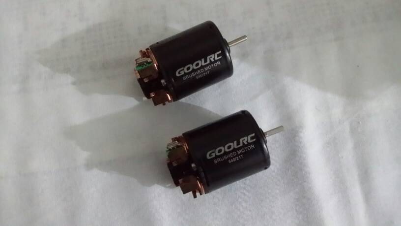

Hello, can anybody tell me with which transmitter and receiver set will work with
these motors? And which is the + and - on these ?Thanks a lot.ImageImage

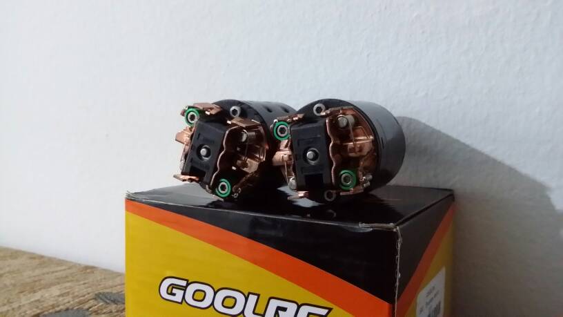

And which is the + and - on these ? Thanks.

To the best of my knowledge, the motors used make absolutely no difference to the transmitter and receiver. It is the control board that operates the tank that is important. A quick check say they are both 100 watt motors, with a maximum current of 28 amps. you will need to check whether both your control board and the motor wiring will handle that srt of current . Different boards are able to handle different currents.
Most motors have the +ve marked, either with a very small + sign or a red dot somewhere. I have just gone through that exercise with the motor for my Puma, and eventually found it imprinted in the black plastic top on which the brushes etc are mounted.

Hello sir, thank u for ur answer. I m not going to use these in a rc tank but in an rc boat . I dont know what ESC to buy to make them work
