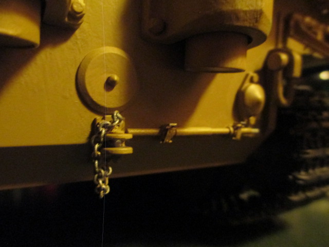

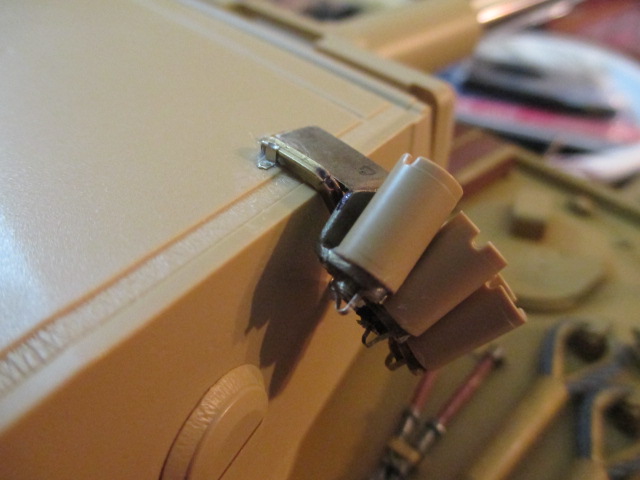

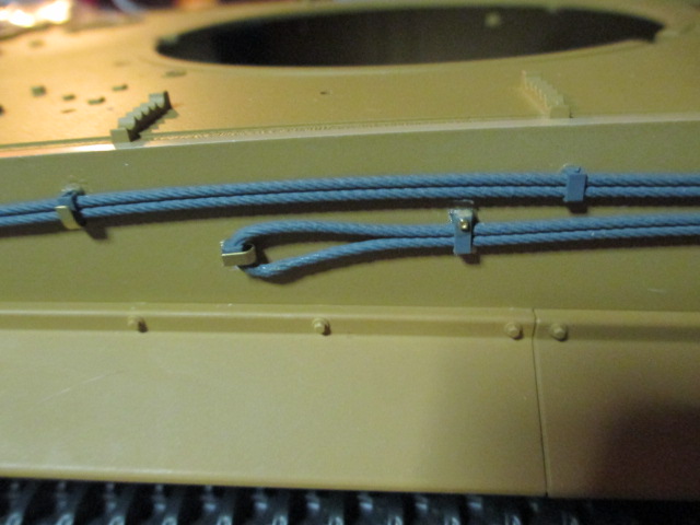

Here are a couple of pics of examples of the combo parts:
- The jack handle is the stock Tamiya part glued into place with ABER brass glued on to simulate latches.
- Same on the tow pintle and chain.JPG (83.58 KiB) Viewed 2054 times
- Brass is a direct layover of the Tamiya mounts which are glued into place
- Works reasonably well using the stock Tamiya cables.JPG (84.88 KiB) Viewed 2054 times
