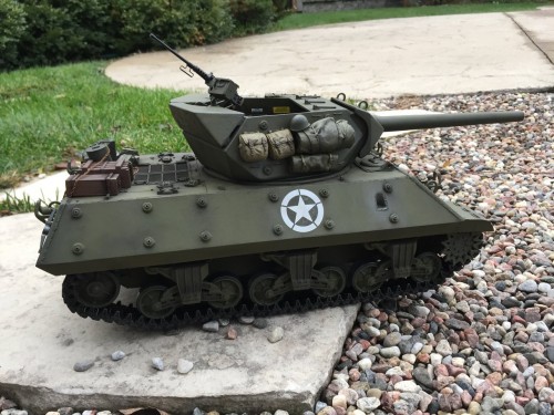

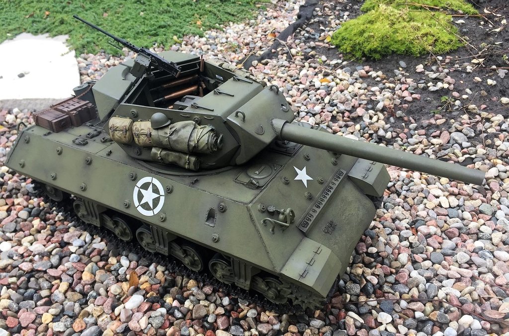

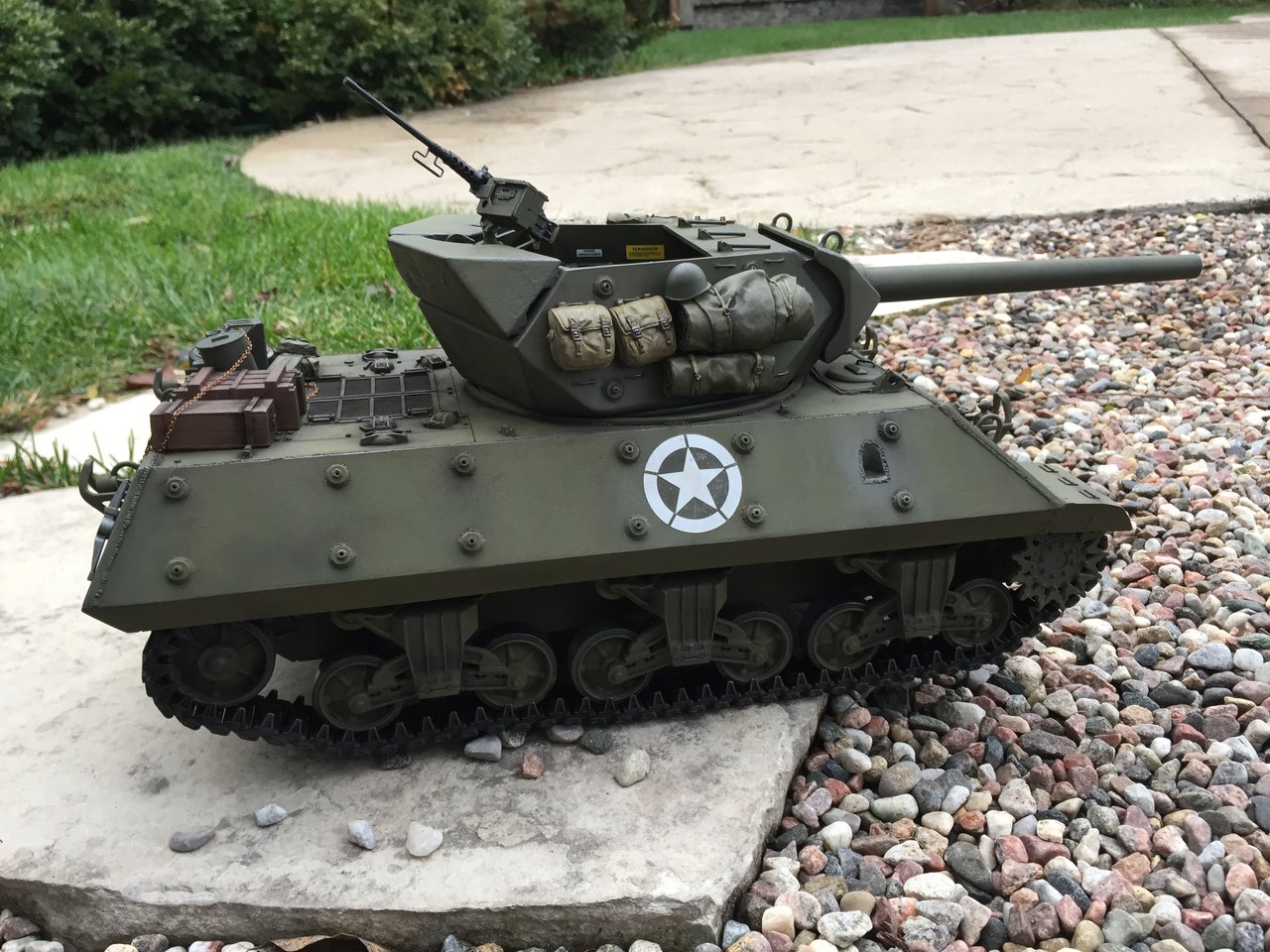

Hi Afrikakorps,

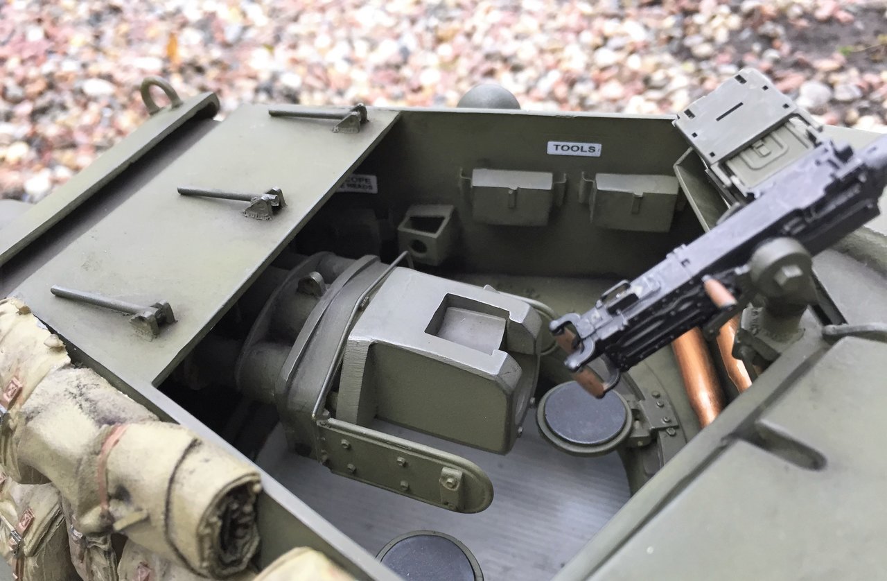

The M-10 was difficult to improve but it was an interesting kit. The angle of the rear hull is wrong and needs to be redone for accuracy and so that you can position the rear lamps properly too. Front angle is wrong too but left it like that. The turret is way too high but I managed to reduce it by 1/4 inch in height by trimming material at the top and bottom before gluing it to its rotation base. Also need to rework the turret rear weight for the right angles and fit. Even then, the turret is still to high and seems to be missing something in length. If I had to redo it, I think I would create a new turret and reuse some of the resin material. As the turret is very weak, the very thin resin panels are holding on with superglue, I only gave the turret a rotation and focussed instead on giving the interior some accuracy. A little hit on the turret by something hard and the whole turret will auto destroy, likely like the real tank... The gun breech and interior accessories have to be redone because they did not look like the references, I re-used many of the provided parts with alterations and plastic cards/tubes/metal. The model is just to drive around, carefully.

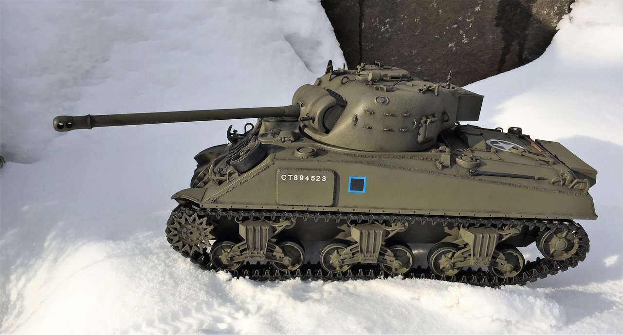

As for the Firefly, it's an easier conversion. I only extended the lower hull like many guys do, and corrected some basic stuff like the rear bin shape. The angle of the loaders hatch is wrong but I left it like that.

Very nice work Imcq11
Your finish and attention to detail is superb !
As with many of your tanks, these are too good to use as anything other than drive around tanks.
A job well done.
