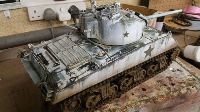

Re: Winter Paint
Posted: Tue Feb 21, 2017 11:39 pm
by Aussie
Here's a nice looking Sherman with a great white wash paintjob.
Re: Winter Paint
Posted: Wed Feb 22, 2017 12:21 am
by c.rainford73
Aussie wrote:
Aussie that's a really nice looking Sherman is that yours?
Carl
Re: Winter Paint
Posted: Wed Feb 22, 2017 2:26 am
by Aussie
No way mate , I'm not that skilled.
Found it on another forum.
