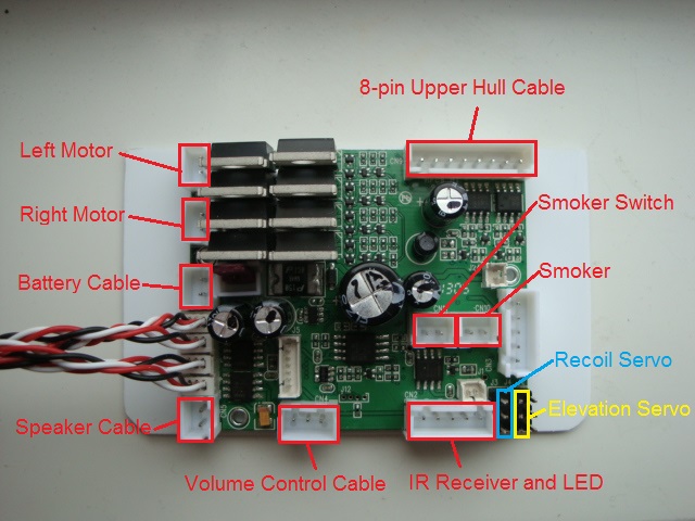

Hi, Richard if that's the two pin connector from the gun microswitch, then it connects to the C3 socket (5-pin) on the Clark TK-22..the bottom two pins of the five pin socket specifically (immediately above the Recoil and Elevation servo connectors in the diagram. It carries the signal that operates the gun sound/track recoil and BB firing mechanism. Hope this helps, Roy.
Tk-22 connector arrangement.
Clark TK-22.jpg (95.49 KiB) Viewed 8772 times

Thank you for that gem, Roy. It is my long term intention to turn it into an IR battler, but in the meantime, it will be good to have everything operational.

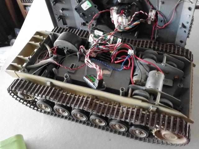

I've been occupied with other things, but this evening, I tried to put the top back on the tank, with the Clark board fitted. It don't fit! The battery box is definitely going to have to go. Looks like a trip to Hobbycraft for the epoxy resin tomorrow.

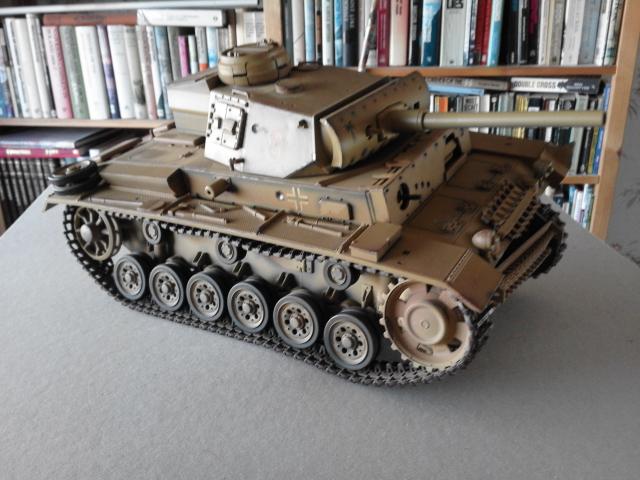

Just a couple of photos. The cause of the lop-sided appearance in the first photo is apparent in the second. As I said - not enough space for the Clark board. I am collecting bit and pieces which hopefully will enhance the tank, though how well I shall do in matching Spartan Track's paint job, only time will tell.
