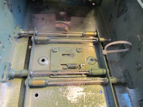

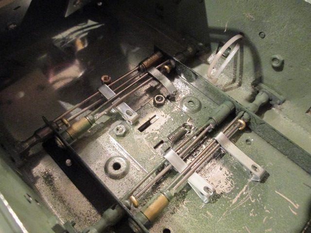

Good morning,
Back when I was building the 'Palace', the tank was simply too heavy in the rear for the existing torsion bars. I used two mods to bring it up to level. I used a brace on the rear four bars and added a extra torsion bar for support to all of the mounts. That was a lot of work but the weight of the vehicle required it. I know that Tamiya has some sort of carbon fiber torsion bars out there which are supposed to be 'wunderkind' for heavy vehicles. That might be worth searching out.
