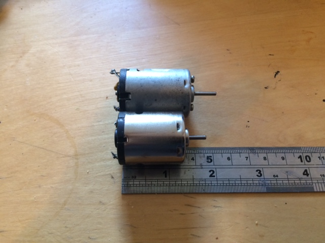

is this the motor youre after?

yip, the little one!
