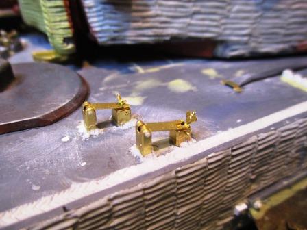

As for the dremel tool I learnt the hard way about overusing it. It seems like the easiest way to remove large areas of plastic, but you have to take care not to melt the plastic in the process or gouge craters in the surface of your tank that will need filling afterwards... as you can see from this picture!
