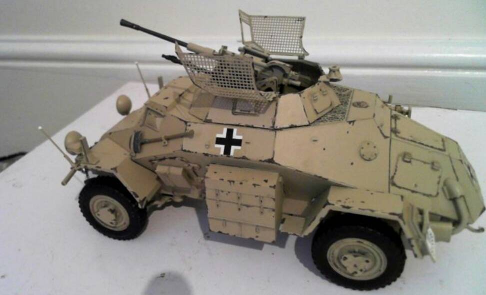

Hi guy's,
I was lucky enough to purchase this little beauty recently, it is the Andrew Design sdkfz 222, it's not a runner yet and that's where my questions begin Image it came with the motor and housing so I now have to get a steering servo, esc and a few other bits, I'm hoping to find something that would be compatible with my spektrum Dx6i. I'm wondering whether it would be possible to use off the shelf parts like the servo and esc or would it have to be the right kit to go with it Image I would just like it running really , no need for sound turret movement etc, so any suggestions or a point in the right direction would be much appreciated,
Cheers, Lee

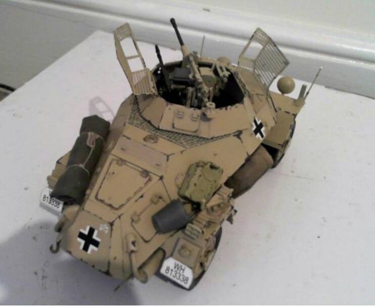

Re: Sdkfz 222
Post by EddyK »
Hi!
You have very good looking 222!
As for board, I'll try to mount in Elmod M16 half track board in my next Sd.Kfz 223 build. It has turret rotation, gun sound, barrel elevation etc. For my Sd.Kfz. 222 now I'm using Elmod board, that is possible to buy at xion.de. One more possibility is Asiatam Opel Blitz board.
