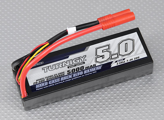

This is what I used:
http://www.hobbyking.com/hobbyking/stor ... duct=21001
The battery dimension is exactly the same as the Heng Long battery compartment. You will need to open up a little bit in the battery compartment on the top so that he heavy gauge wires and bullet plugs will go into the hull. Now if you have a metal Taigen hull then you don't need to worry. Fits exactly as the stand Heng Long battery but packs a punch and last a hell alot longer.
You will need to get a bullet type to Tamiya plug converter but you can get it at Hobby King too.

I bet you they probably make it for Hobbyking as they look identical in the packaging although for some strange reason HobbyKing is cheaper. I think it is also 40C whereas the Hobby King ones are only 20C.
Barry, are you on IBU2 ? I know Clark won't handle 3S. Don't know about Elmod. None of the Heng Long/Taigen/Torro stuff will handle 3S either.
Edit, sorry Barry....... Just re-reading your post, I think you are going with Clark, right ? In which case you won't be able to use 3S, only 2S, and even then I have had some issues with freshly charged 2S which could delivery up to 8.9v. I think Clark has fixed it now, but I have couple of boards died on me.

No, HK are made in China, SMC are made in the states. I've got HK Turnigy and zippy batteries and those tend to be physically larger soft packs than the equivalent SMC (and other makes like Gens Ace and Reedy) hard pack and have lower specs. HK really are the absolute bottom end of the spectrum when it comes to batteries which is why they are so cheap.
