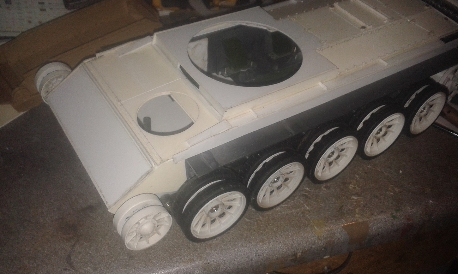

I'd acquired a WSN T34 at a MAD meet last year (All are welcome pop in and enjoy a meet in Manchester) So many things were in its favour as a donor chassis not least the Christie suspension so out came the saw and it got hacked

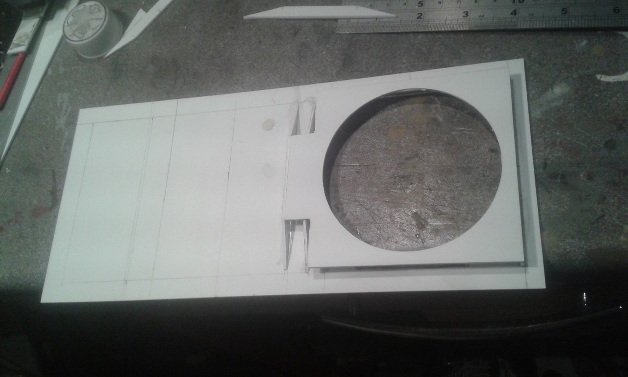

Having glued the chassis back together it was time to start on fabricating the upper hull, this is where the WSN hull is great as the gearboxes fit very nicely low down and don't interfere with the fit (I know some don't like the gearboxes but ive run my metal tracked tiger on them for over three years with no problem. I made the engine deck with a support layer to give it extra strength and this also helped with mounting the motor for the turret ring as its nice and stiff. I love working with plastic card and its fun working out the angles so that it goes together like the real thing

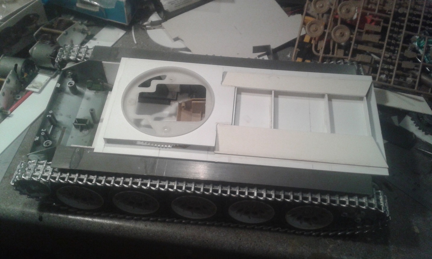

The standard HL turret ring is just the right size to fit width wise. The pic also shows some Kenny Kong Pzr IV tracks that I got for a 1/15th Pzr build the intention is to modify these later to make them more like the British tracks. There will be some major mods to the chassis eventually

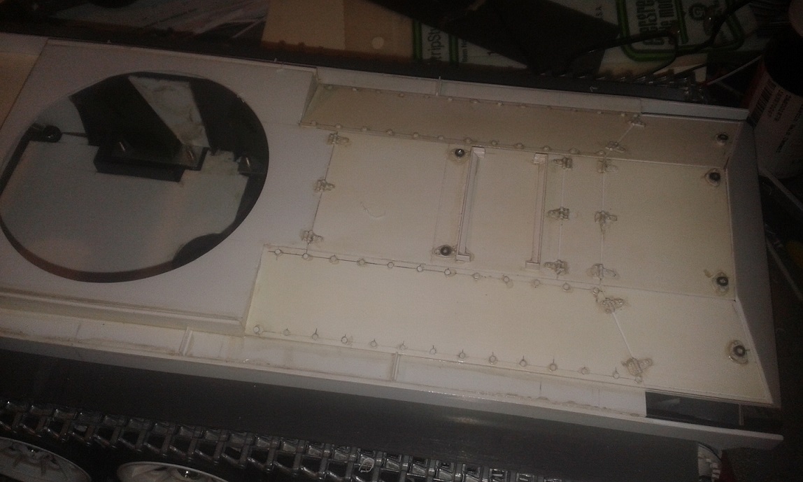

Back engine deck built up, nice and solid, all the bolt head detail is from hex styrene rod. All the detail is just careful plastic
