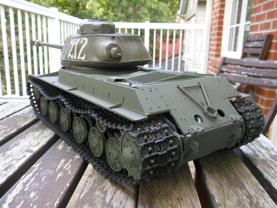

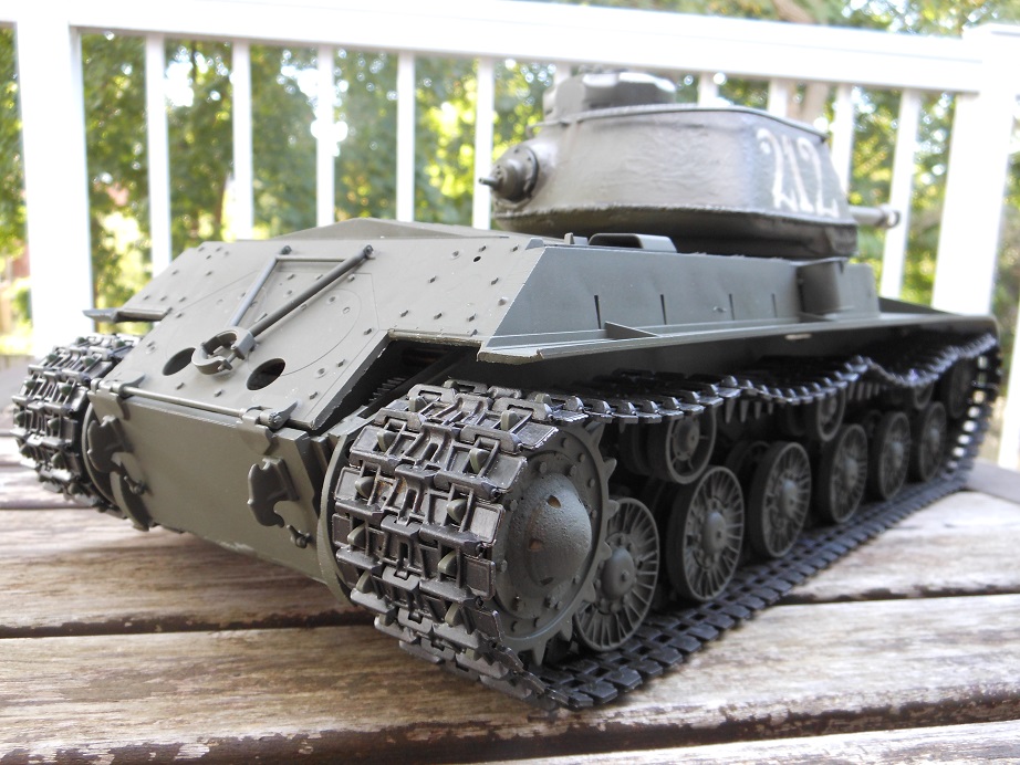

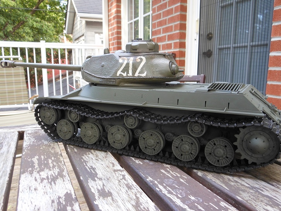

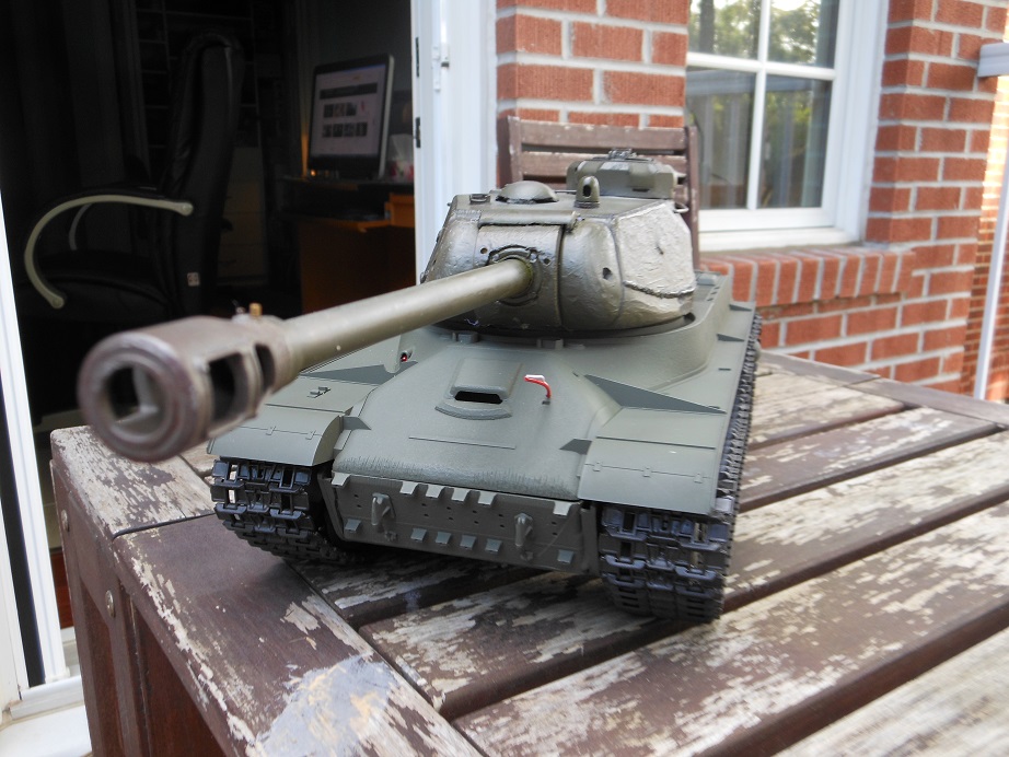

Been drooling over the Tamiya JS-2 since it came out but just couldn't pull the trigger on $1,000+ (CAD) full option so decided to take a crack at making one for half the price with some of my existing pieces. Here are the parts department and pictures showing where it is at the moment......
Turret - Junkenburg IS-85 which I have modded into a KV-122 turret. It was sharing a KV-1 lower but now it is used as the early IS-2 turret
Barrel and Muzzle Brake - Frank's 122 mm JS-2 barrel and DKLM's Russian style metal muzzle brake
Upper - Tamiya JS-2 plus most of the dressings from JC-RC
Lower - Heng Long KV-1 but cut length wise to make it fit the slimmer Tamiya JS-2 upper
Wheels/Sprockets - Juckenburg JS-3 kit
Electronics - Clark
Still debating to get more Tamiya parts to finish it off but that will jack the cost up substantially.

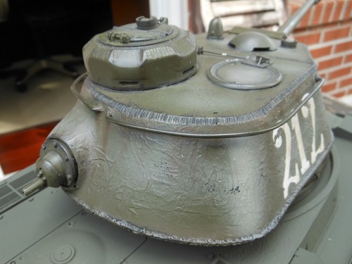

Kiaser wrote:MichaelC if possible I hope it is not to much to ask for some close up pics of the turret ???

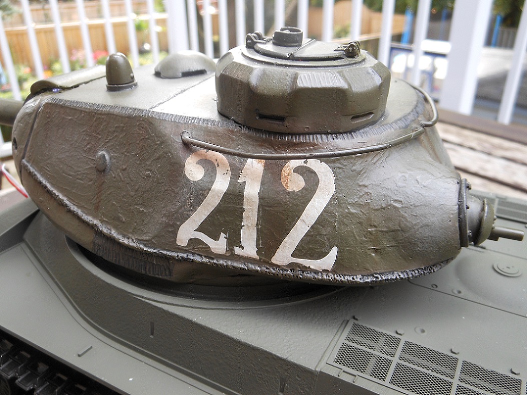

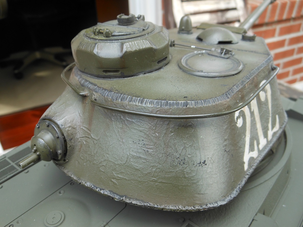

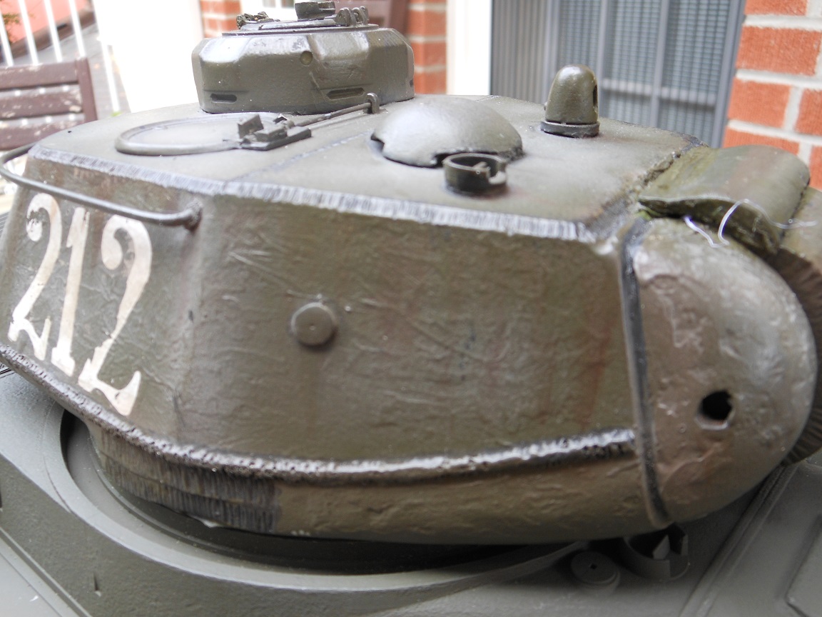

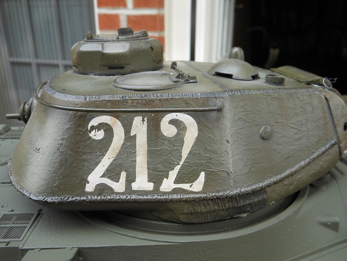

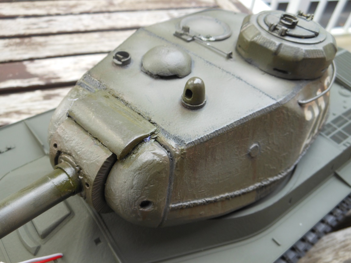

Kiaser, here is some of close-up of the Juckenburg turret. As always his resin work is top notch as you can see all the weld lines are faithfully reproduced. The paint and weathering is done by dgsselkirk as part of the sharing of the KV hull so I have to some how either re-paint (!!!) or get him to do the rest of the hull the same way. Also you would notice that it has a narrow mantlet which is true for the KV-85 and the early IS-1s with the 85mm and the 100mm. I comtemplated using the Tamiya wide mantlet but it was too much work. In theory you would never see a "Roman Nose" IS-2 with a narrow mantlet.
