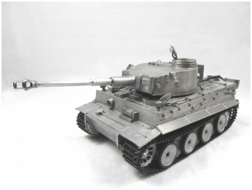

I personally like all-metal Mato with IR gun too bad they do not paint them into green camo :-) I'd love to get it as kit for assembly. Lack of the frontal spare tracks means it's late version?

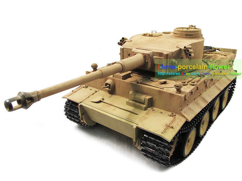

The Cupola, the Feifal air cleaners the location of the headlights and the lack of front spare tracks all point to an early Tunisian campaign Tiger 1, Shaun

This is my Taigen I think the picture you posted is an early or mid tiger mines a late you can tell by the wheels

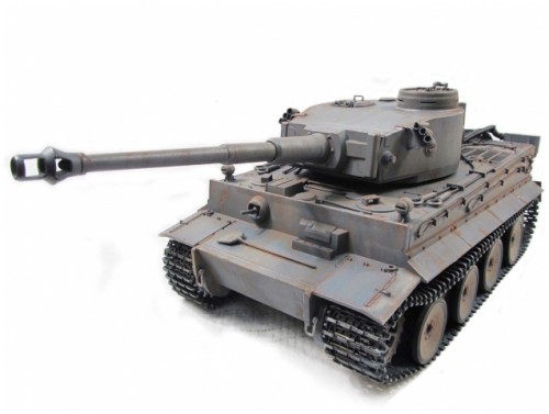

I still like the metal Mato most :-)
There are 2 more color options (grey and original metal) - would like to hear suggestions on which one to choose. Since everybody says METAL almost 7 kg should be way to go! Or isn't it too heavy for 1/16 model?
