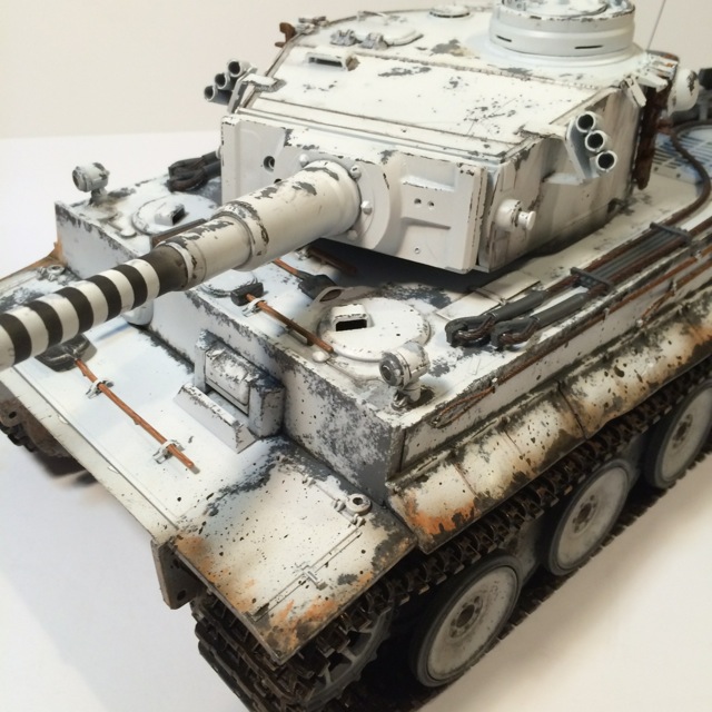

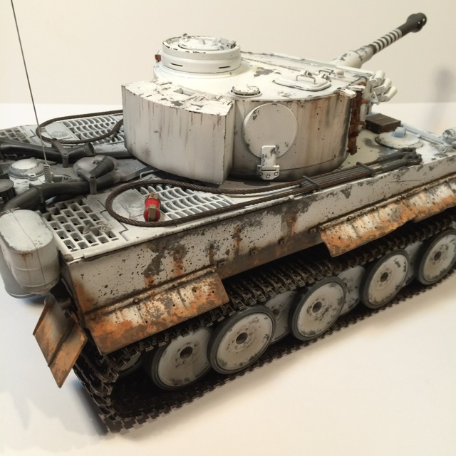

Hi fellow tankers.
Some of you may have seen my Tiger a few months ago when I joined the forum. I just thought I'd show what I've been up to with her. I have even tried some of the corrections on the list for fixing Heng Long Tigers. Some I'm not yet brave enough to attempt (like centering the turret). Still not completely accurate I know but she's a work in progress. There will be markings, but as yet I'm undecided and I went ahead and started weathering (not ideal I know).
Since she is an amalgam of tanks that may have been updated through out the war and served on many fronts, she may not fit any historical photos, more my imagination I guess.

Thanks Shaun, yes, I have rotated the cupola (hopefully enough) it but I didn't amend the visions slots. I should do that one. I didn't want to mention the cricket. :)

Nice work, I very like it all rusty pieces, looks really!

Wow you did a really good job on that paint and weathering! :thumbup:

With a working tank, it can be a challenge to keep everything stuck to the tank. I've tried to make this a robust build. It's a theory anyway.
