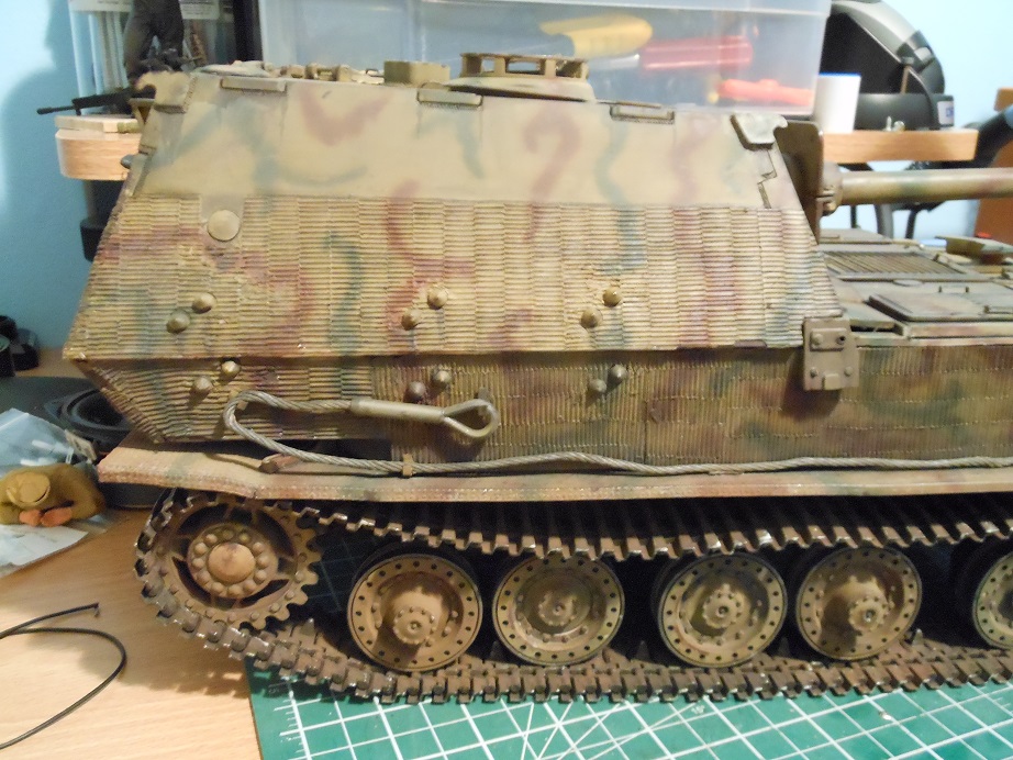

jack, I have used both and the Tamiya ones are basically stick-ons. If you compared them to putty or Atek zims you will be disappointed as there really isn't much texture to speak off, almost like a really thick sticker. I am not a skill guy so I find the Atek zims, although pricy, quite doable. You basically get the matching set, fit, trim (if necessary) and superglue/CA glue them on. Here is a picture of the Atek zims on my Asiatam Elephant:
