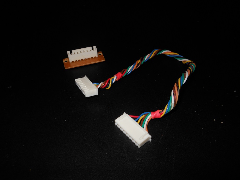

This is what I am sending you on Monday:
