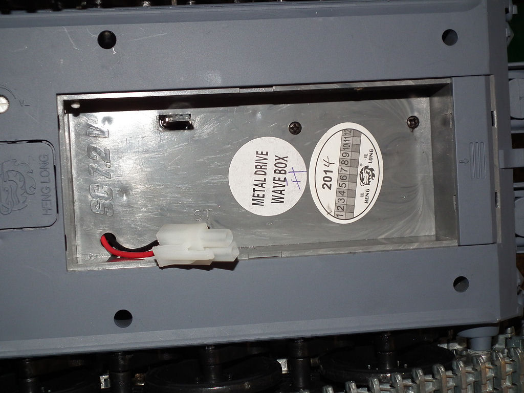

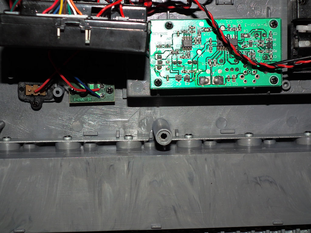

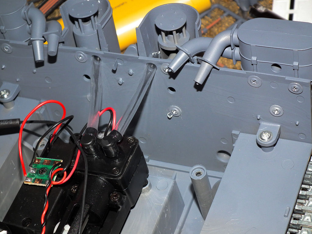

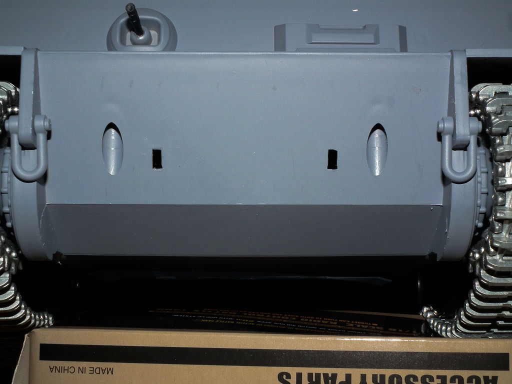

Hi
Brought a Heng Long Tiger I a few days ago & as I am going to change a lot of it have been looking at forums & the net beforehand on how to strip it down.
Imagine my surprise when I looked at my new one against what I have read mine is a new style hull & some of the mods have already been done :-). As you can see from the pictures there are now only 6 screws to take out to release the upper hull, but 2 of them are hidden behind the plastic spare front tracks that easily unclip. A lot of the rear parts like exhausts, toolbox & air filters are just screwed in easy to take off.
The hull has had metal bracing for the suspension, but please note that due to the new position of the screw mounts this is now a 2 piece unit & not just a single strip. Also the road wheels are now an allen screw fitting with just a painted "rubber" effect on the edges.
Mine was date stamped as 02/2014 & I hope this helps.

And I am sure the turret position is correct & does not need moving back the regulation 1/2" inch.
Mine was the same as yours.

I find the new screw points interesting...means Heng Long did change the mold for the lower Hull...could be the reason I've never had problems with my tracks and the new one does :think:
