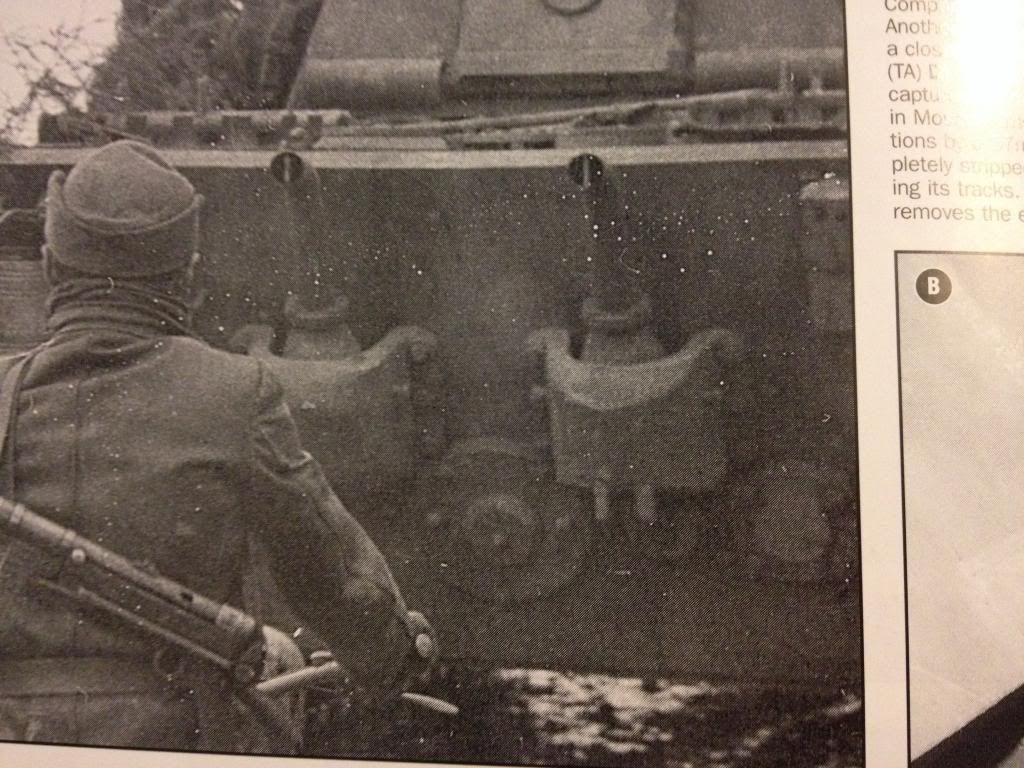

Hmm, an interesting point I hadn't considered before! After looking through my books and some videos of the Saumur King Tiger it appears the Porsche turret King Tigers had the exhaust covers in your second photo, i.e. both exhausts had the cover with the distinct ridge down the centre, and the King Tigers with the production turret had one curved cover on the left exhaust and a ridged cover on the right exhaust. As Billpe says, Jentz and Doyle are the Panzer gurus, the Thomas Jentz book "Tigers At The Front" has a number of photos towards the back showing the production turret version and you can see the chamfer of the ridged type cover is evident on the right side exhaust cover and the curved cover is fitted on the left, so it's a bit of a mystery why their drawings only show the ridged type!. So if it's historical accuracy for a late version I would vote for the covers in your first photo, i.e. one of each, however that would mean I'll have to go and change mine now...... :/ However whatever you decide for your tank is right as it's your tank and your interpretation of it, so as long as you like it that's what counts! :thumbup: And of course the main thing is please treat us to lots of pics!

Markocaster
Posts: 997
Re: KT exhaust cover upgrades
Post by Markocaster »
According to the text this is a post Oct 44 vehicle.
