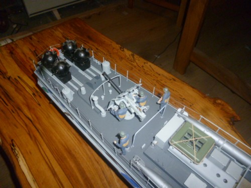

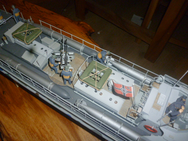

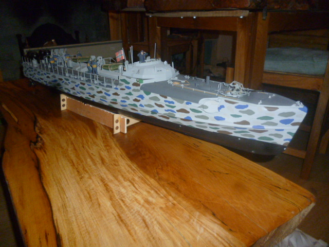

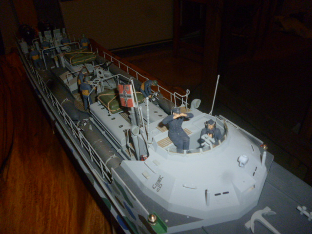

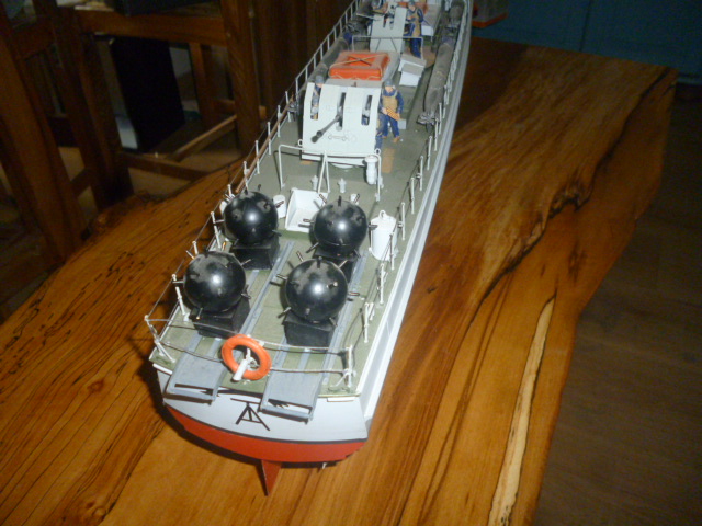

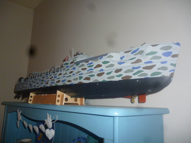

Hi guys,..have been busy working on my S100 Schnellboot,.in between working on the table she is sitting on.....she has been done in the camo pattern of the Baltic Flotilla,..sh measures 100cm long x 12.5cm wide,...she is running 2 x Graupner speed 400 motors, coupled to 2 x 30mm cast bronze props,..she is rigged for 4ch operation, but i,m only using 2 at the moment,..the other 2ch,are for opening the torpedo tube doors, and to operate the navigation light,...she sails very well,..i,ll post pics soon of her, and the Bismarck...on their maiden voyages...

Excellence, truly a great looking E-Boat. Really like the scatter pattern camo. deck detailing and crew. Mines are a nice detail as well.

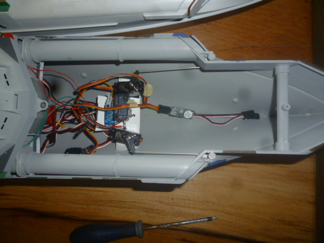

How do you access the internal compartments? Does the Pilot house lift off or deck sections? Curious about the layout as well, Are there internal bulkheads to restrict water flow? Does the pilot house act as a dry chamber for the receiver? Really want to build this kit and have for the longest.
Do you know of a Drive package designed for this kit?
Thanks,Blake
Thanks,Blake

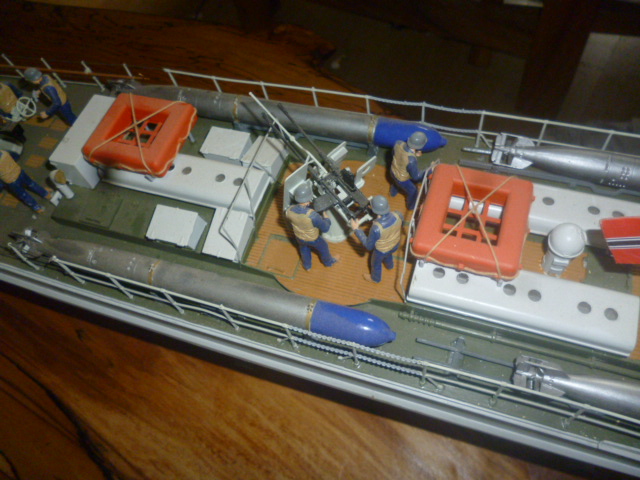

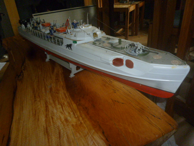

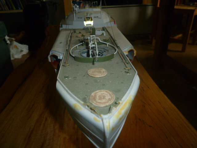

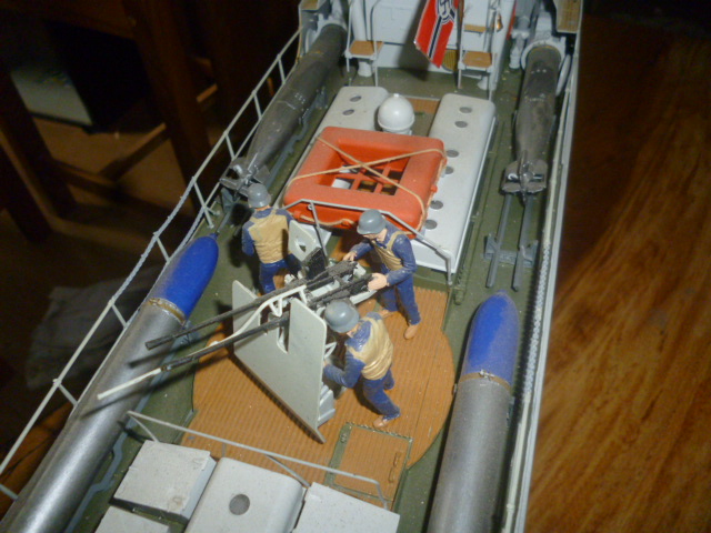

Here,s some pics of my other Italeri Schnellboot....same kit as the other one..but this time, dressed up, for operations in the English Channel...

Hey Earwig... are these RC? if they are...did you have to counterweight the hull for them to stay upright ? the draft looks rather thin
Re: Italeri S100 Schnellboot

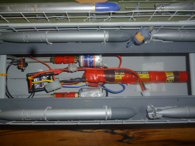

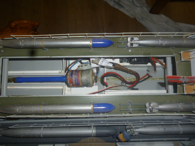

Hi Blake/Alpha,
as you can see from the pics.the whole centre section lifts off, on both models, and the bow section of the mottled camo one, in this one there are micro servo,s to operated the opening of the tube doors, there is also a slow switcher fitted.so that the doors open slowly as opposed to what they did before the switcher was fitted...they flew open,also fitted is a micro-switch operated by a mini servo..to control the navigation lights,...To answer your question Alpha..these boats were designed for high speed, and sat on top of the water,as opposed to in it, and their draught was very shallow,..these models have everything fitted low down in the hull and with the weight of the motors and battery very little extra ballast is needed ..for these 2 i,ve only had to add 100g of lead ...e.g weights that are fitted to balance car wheels...To answer your question Blake,the electrics are all waterproof,..apart from the receiver, it sits in the hull in a waterproof plastic box,..these models can take 3 x 380 motors or 400,s, or in the case of the non camo.d one..a single 600 motor ..the props are D-type with a long centre boss, .the blade profile is severe..so that they act like a large screw as opposed to a normal prop.

Thanks for the explanation Earwig ...Nice work
