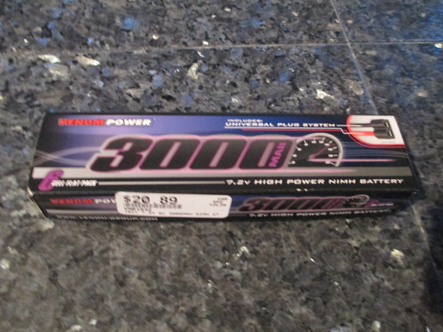

Good Evening,
Go and get one or two of these and put your savings back into your pocket. It is a Venom Power 7.2 volt, NIMH 3000MaH and comes with a variety of plugs and ran me 20.89 US retail + tax from Hobby Town, a local shop. They can probably be found even cheaper online. My tanks really came to life running on this battery vs the HL stock battery.

Whilst that is a better battery than the stock yellow one
As painless says, you could do so much better.
I would say at least 3000 nimh.
Also try & get a branded battery as the cheap ones are never
As good as they say they are.

On the batteries I agree with the boys get a better battery. I run Turnigy 3000 and 5000. In my KT which has all kind of extra power draws (double upgraded speakers, convoy light, 480 motors, waltherson gearboxes, metal sprockets, tracks, clark board) the 5000 will last 2 to 3 hours fairly hard running. The battery you are showing here is the standard one we get in with our Matomart tanks. It lasts about 20 mins in my KT. Good as a little back up but not much more.
Make sure you get a good charger too. The ones that come with the tank are useless for so many reasons the main one being they have no monitoring system so no automatic cut off when your battery is full, no cell checks, nothing. The good ones are not that expensive. I think I paid $30 from Hobby King for the one I have now.
