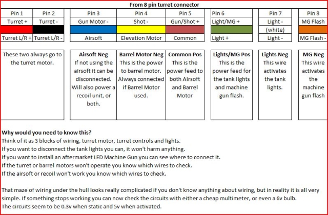

It can be converted, I did one, and ran it on 7.2v the motors will function ok on that voltage. If you look at the battery pack I think I remember correctly that WSN ran a reduced power to some of the circuits by running a pair of wires out of the pack mid way down it.
Your best bet is to simply cut the entire WSN wiring loom out, and remove all the wiring from the turret including the led's.
Leave a black red on each motor.
Leave a black red on the turret rotation motor.
Leave a black red on the elevation motor.
Now you only have 5 pairs of wires to worry about.
You will need am HL wiring loom unfortunately as like Tankbear says the plugs are a different size.
If you aren't confident with a soldering iron, use screw block connectors to hook things up. Its actually a good idea to test the circuit prior to soldering using block connectors in case the polarity is wrong on any of the motors.
Connect one pair of wires from each motor to the HL red/black.
Connect one pair to the speaker.
All of the turret wiring goes onto the 8 pin HL plug, as per the diagram.
Make sure that you start at the correct end.
Once its all hooked up the tank should run just like an HL.
