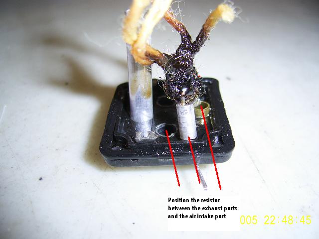

I still have a couple of 14 OHMS 1 Watts wire wound resistor left...
My supplier is sadly out of stock for those ones.
If you can't find any, just P.M. me your mailing address and I'll send you one with the wick...
I'm presently experimenting with some 15 Ohms 1 Watts wire wound resistors that I bought on e-bay...
They produce a lot of smoke; but I don't know how long they will last...
http://www.ebay.ca/itm/121111677488?ssP ... 1497.l2649
Also make sure that you install the resistor in the air flow between the air intake and the exhaust ports of the smoker; for best results.
- 7.JPG (37.69 KiB) Viewed 2682 times
