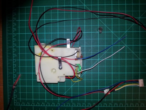

I have upgraded my Tiger I with an ElMod control unit and Taigen/AsiaTam recoil unit.
I get the elevation motor and the flash LED to work but not the recoil motor, it is a white lead to the recoil motor,
shall this be conneted somewhere and in that case where?
And the blue one, shall that be connected somewhere
I have connected the thick red lead to the negative side of the battery.

From what I have read from the Guy's n Girls posts , the thin white and blue wires need to be soldered together.
These would have gone to an on/off switch if present .
Wait till you have another member confirm this L07 , I have to fit a Recoil to my BB Tiger 1 at some stage so have
looked at the posts and this is what i seem to recall

Thanks!
That solved it.
Next problem is that the recoil continues if I do not flip the fire trigger back.
I saw that some else had that problem, with the micro swith.
But this is a minor issue, just remember to flip back the switch on the Tx.
