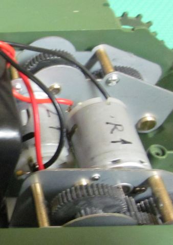

Typical stock HL motors/gearboxes in a Panther or Jagdpanther
HL Panther Stock Motors, Gearboxes.JPG (28.96 KiB) Viewed 623 times

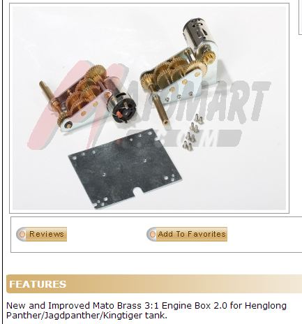

Mato 3:1's, note that the narrative mentions the JP
Mato 3 to 1.JPG (37.09 KiB) Viewed 623 times

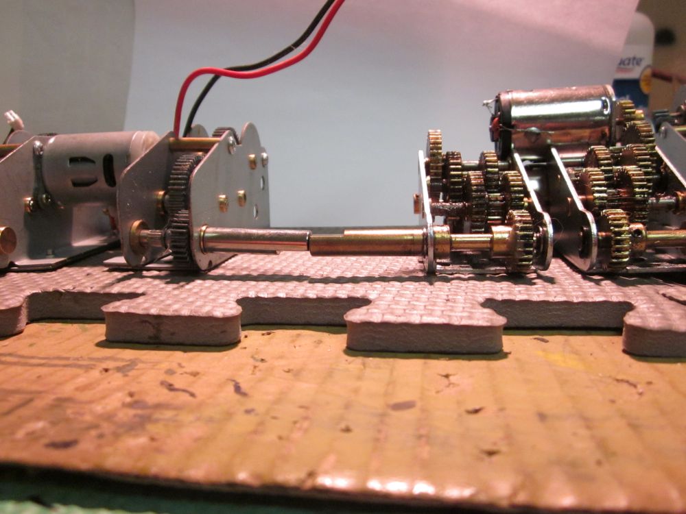

Height difference in the stock HL and the same Mato 3:1's, note height of the motor on the right side of the picture.

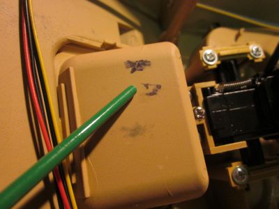

The green paint brush handle points to the black mark where the top of the left motor on the 3:1's interferes with the upper hull.
IMG_1046 small.jpg (34.54 KiB) Viewed 623 times

Looks like these are low enough to fit, if the ends of the motors don't contact each other.
http://www.welshdragonmodels.co.uk/asia ... -586-p.asp
