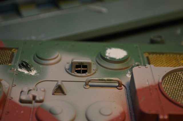

After adding engine grills, I removed the engine cover hooks and re-fixed them back facing the right way, facing outwards. I took off the external antenna connector and filled the hole. I also made the cross grill for the rear vent out of metal from a coke can and glued into place.
Once that was done I used a small piece cut from an old dish washer filter for the inner grill for the vent. The white bits on the corners are sodium bicarb which when sprinkled on super glue makes it go off straight away.

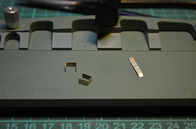

Reading Jeff1101 excellent "HL Panther G customization dairy" (viewtopic.php?f=22&t=8956) I thought of making my own spare track holders. I cut the plastic track that comes with the tank, giving me 6 pieces of track. Then I filled the holes for the track on the side of the upper hull with filler and rubbed them down. Using the metal from a fish tin and a pair of sheet metal cutters. All you need to do is mark a straight line and cut along it. The cutters I have produce a thin strip of metal.
Once the metal strip cut to size and bent into shape, you have a clamp which is just wide enough to fit through the track.
