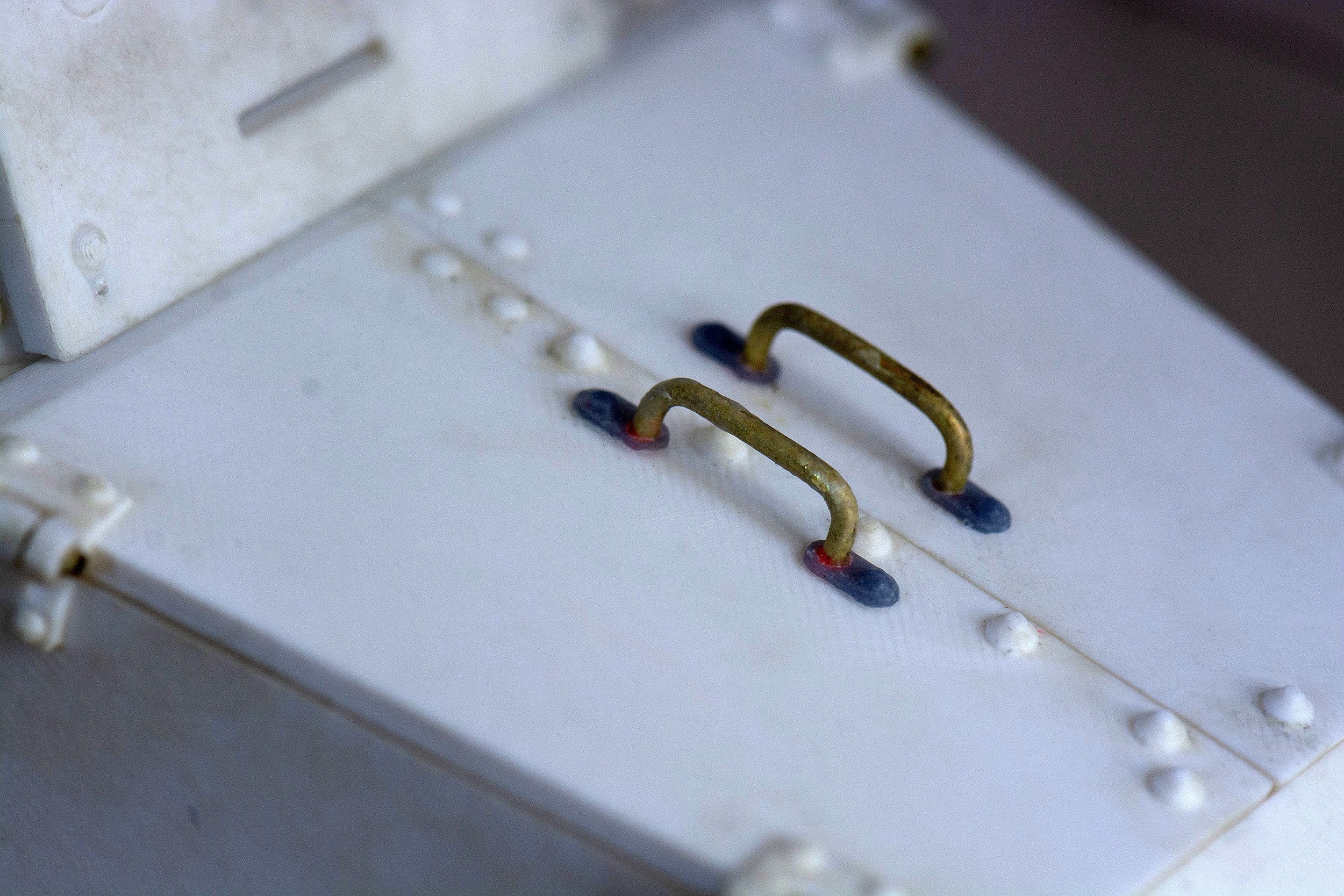

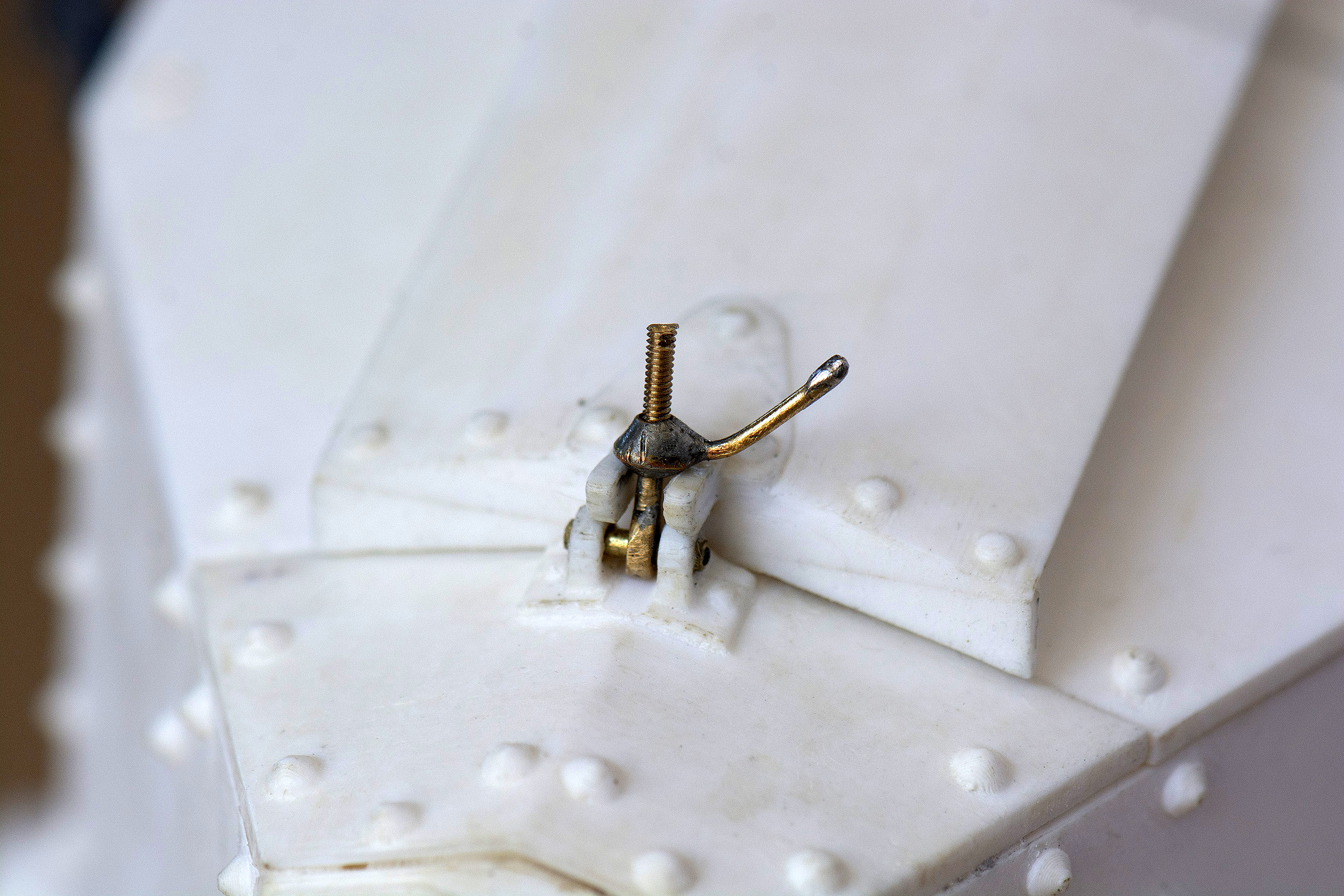

A bit of details to other hatches as well. Riveted plates for handles were resin printed. With a bit of soldering I made a lock for the central engine hatch.

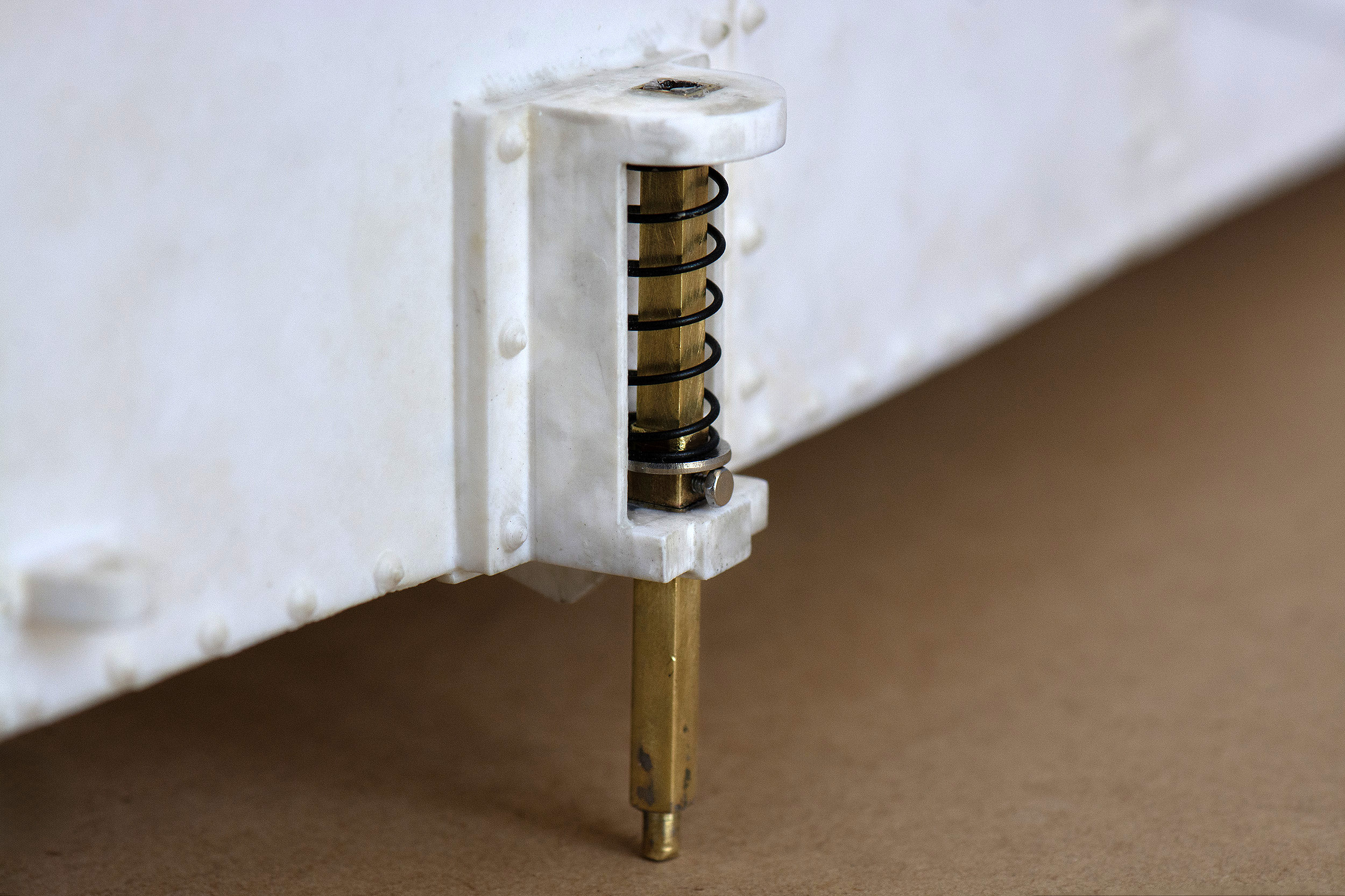

Probably the trickiest part was to make working suspension rods with a square profile. I use a 5x5mm square tube to reinforce holes in the plastic and a 4x4mm tube as the suspension shaft. It would be locked with drive trains by 3mm round rods on top and bottom. The washer is held up by a piece of 5x5mm tube, it is about 6mm long with rounded edges for the top 3mm (to fit the washer). M1.6 bolt holds all pieces together; if I unscrew it, the shaft can be pulled out and the whole suspension disassembled.

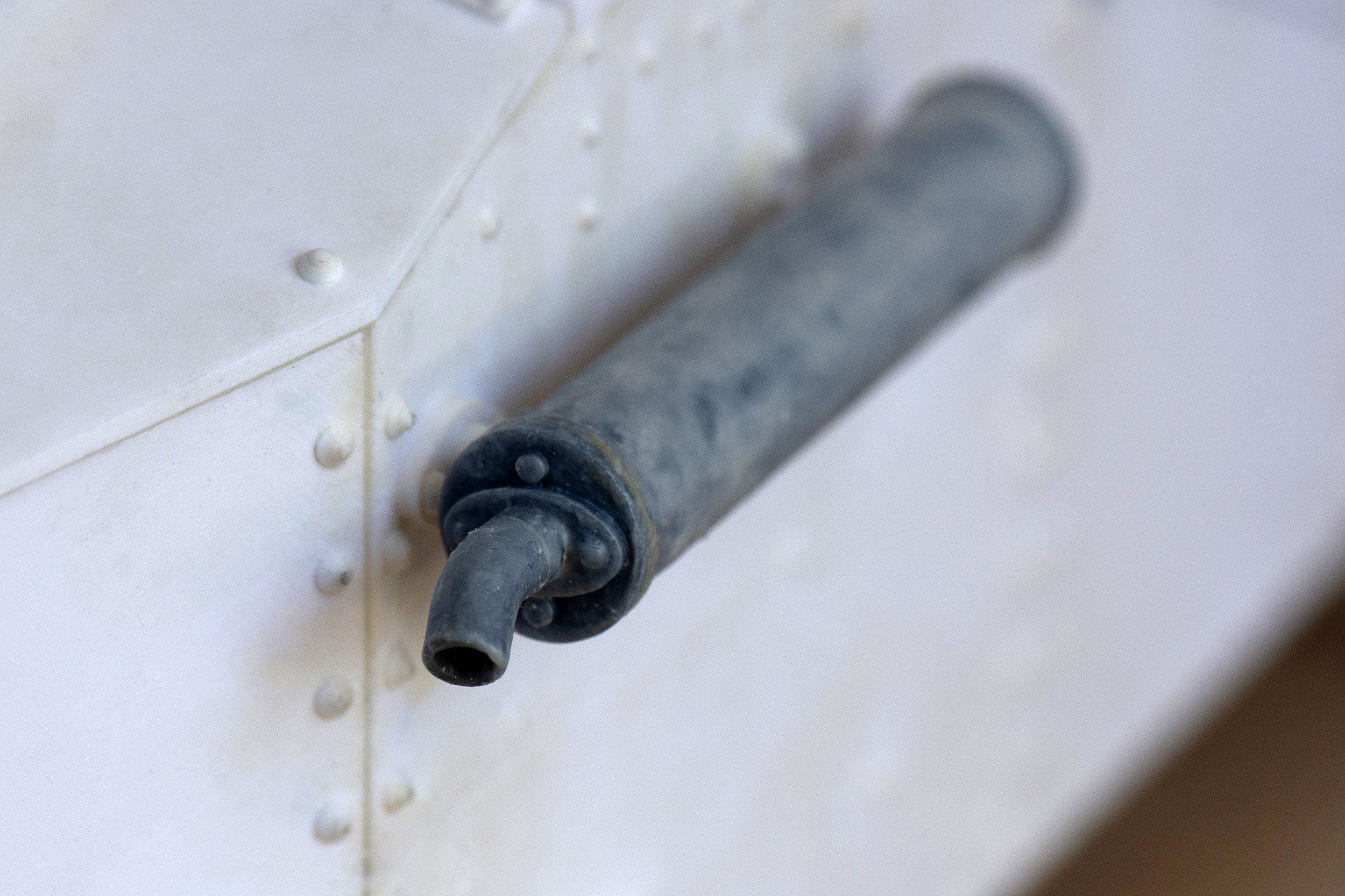

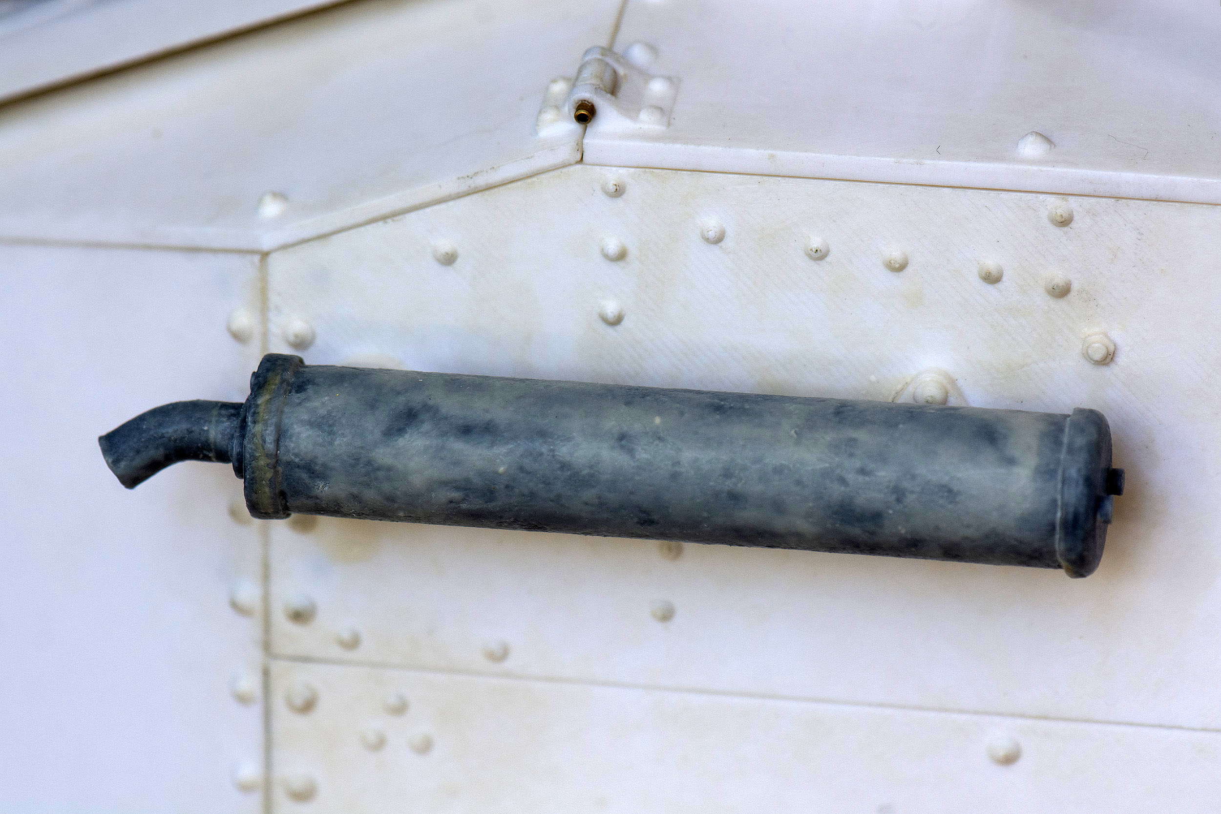

Finally, some texture was added to the exhaust pipe, and it is ready to be primed and painted.
