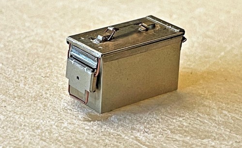

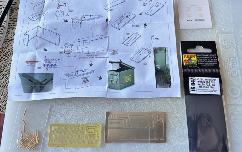

While i have a post open, here is what i did today, an Aber .50 ammo box.
This is Aber kit no 16047, combined ammo box and ammo with links for the M2 Browning.
			-  RC 1/16 M-24 Chaffee light tank- Dien Bien Phu 1954 - Build

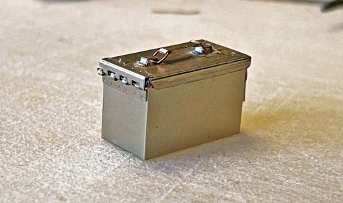

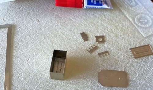

The box itself is square and simple, but some parts are really small and can only be touched and lifted with the tip of a blade, with two pairs of glasses.

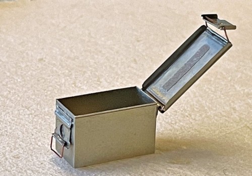

Its everything that has something to do with the 0.3mm wire that is a bit more difficult. But with patience, a few curses to blow some steam, and a cooler head, its doable. I think it will look good with the ammo belt and mounted on the M2 cradle. The ammo box lid actually opens, closes and the latch on the side really locks it, it's cool. First time i see this in 1/16. I usually used resin ammo boxes lately. I think i am converted already. Once you start using these Aber sets, there is no way back.
